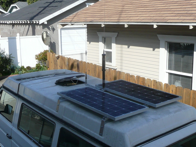

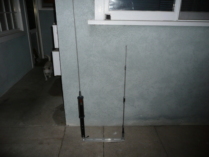

Made up an antenna bracket for the 'Westy' today ... will have to see if it works out, both electrically and physically :confused:

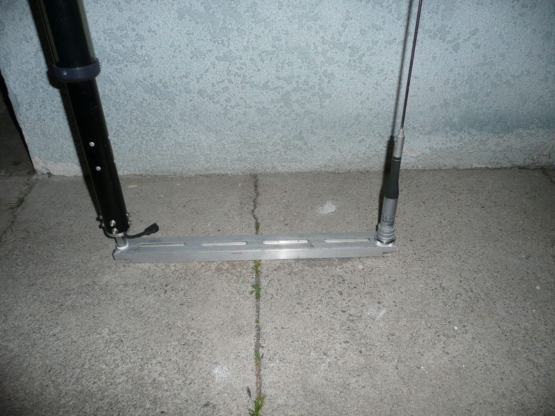

Little Tarheel-II HF screwdriver, mounted 17" away from a Diamond SG-7500 (Super Gainer) dual-bander on a piece of Unistrut - plan to mount it to the front cross-rail in between the solar panels.
Film at 11 ...
I hope so, Anthony ... will give it the smoke test soon :confused:

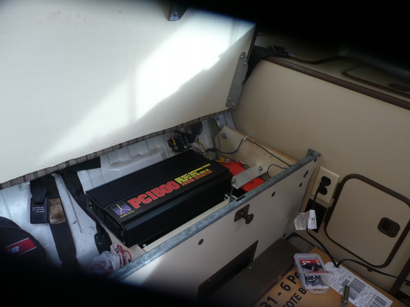

I checked out the empty auxiliary battery tray and battery transfer module under the rear seat today (Saturday). Tidied up the electrical connections, tested the operation, then made a hold-down bracket and installed the Odyssey battery. Also installed the 1500-watt power inverter I've had laying around here for years.
The battery transfer module automatically switches between the main and auxiliary batteries while driving. I will add another manual switch to charge the auxiliary battery from the solar panels when in the stationary mode.

Had to move the panels further out to accommodate the antenna bracket, so I removed them and made up the parallel wiring harness to size.

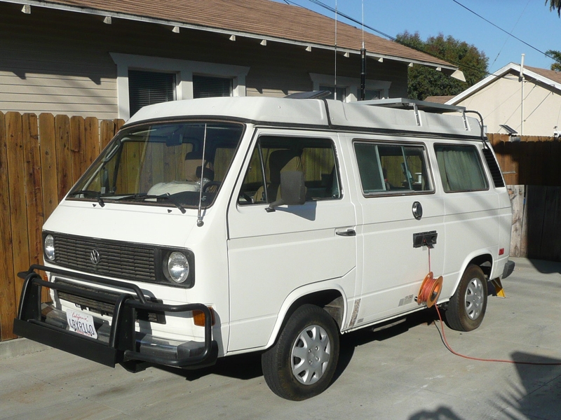

Reinstalled the panels in their new position ... and the antenna bracket.
Next, gotta do all the cable runs (and eventually, a bath) :laugh:
Checked out the fridge on 'shore power' yesterday too ... it works great (y)

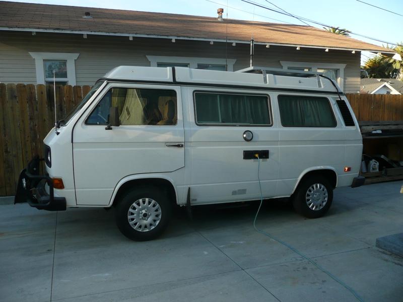

Almost ready to go :w00t:

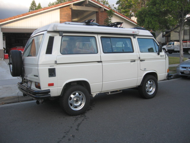

This is what it will eventually look like:

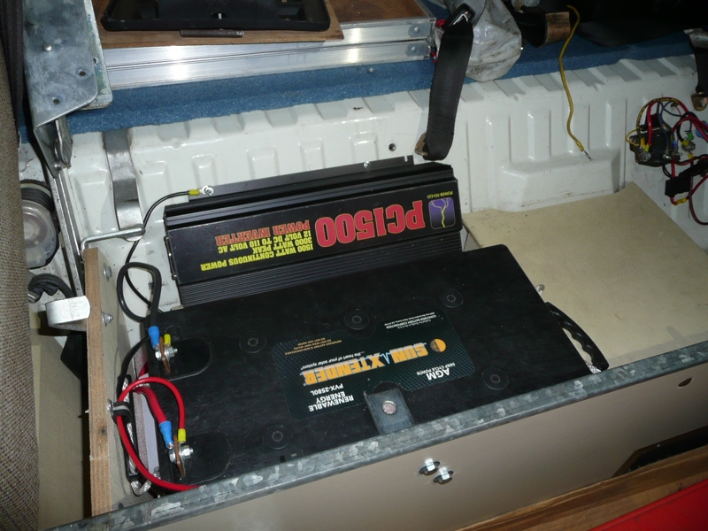

OK, change in plans with the Westy. I had a spare 12-volt 255Ah AGM battery stashed away under my work bench, that was destined for my trailer. It just so happened that there was just enough room for it under the passenger side of the rear bench seat ... so, that's where it is now, along with the relocated inverter.
Had to change out most of the wiring that I had previously installed to the Odyssey Extreme Racing 40 Battery :headbang ... but it was worth the time and effort.
The Odyssey was OK, but it's only a 45Ah battery - and will go in my 914 shortly (y)

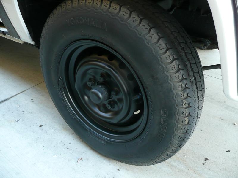

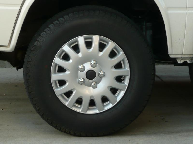

Well, looks like my Mercedes CLK wheel deal has gone sour, so I took off the cheezy hub caps (that were on the vanagon when I purchased it), scrubbed the stock 14" steelies real good and painted them.
I was going to leave the hub caps off, but the Mrs said she liked the hubcaps. Problems were as follows:
1. I was missing one of them
2. They were 4-lug caps (on 5-lug wheels) looked kind of funky
3. The previous owner pounded the caps on and the front bearing grease caps and rear spindles cracked the centers
... so I bought a new set of 5-lug caps at Pep Boys. I drilled out the centers on the fronts with a hole saw so the grease caps wouldn't crack the centers. The rears are OK, but I might drill those as well, just to keep things symmetrical :confused:
It'll have to do until I get my dream wheels. I guess they don't look too bad ... good enough for BURNING HAM III :love:
