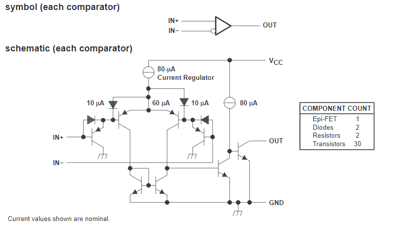

Can LM393ADR drop in replacement LM393MX ?

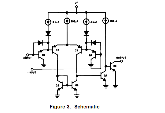

LM393"A"
Revised 2013
However...
LM393"A" through 2007
So, you pick, but electrically the are similar
Only the dates of current platform​
Seems to me you will only know the difference if your circuit pushes the chip near its published limits. At modest supply voltages and output currents, they will perform the same.
