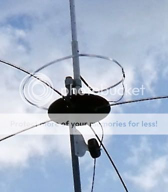

The wiring is pretty easy. My biggest concern was that it didn't seem "right". I am used to typical AC and DC current principles and not RF. Here is the matching coil I built for my ground plane antenna.
I used a 6 ft piece of aluminum flat stock that is about 1 in wide and 1/8 in thick. It can be foud at your hardware store. I used my hot water tank to bend it into a semi circle. I left enough room to bend the ends in for mounting to the antenna system. One end will attach to the vertical radiator, the other end will attach to the ground plane/mast clamp. I took the center conductor of coax and soldered one end to the center pin of the SO239 connector. The other end was soldered to my slide clamp (for making the actual adjustment on the coil)
