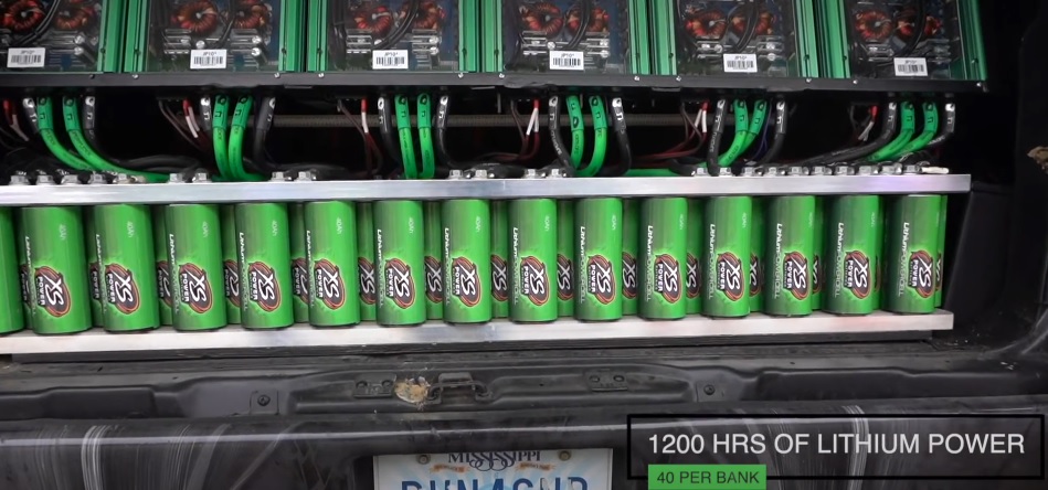

I would be the hard ass to have a battery setup like this just to be sure.. :D
