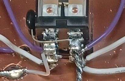

So here's a detail that reveals Carl has a clue.
The small brown lump against the left side of the relay is a silver-mica cap. One side grounded, the other side connected to the relay's receive (standby) side.
When an amplifier is put in line with a radio, the radio's SWR reading should not go up. Should mimic a barrel connector, more or less. But on standby your signal is carried by several inches on NON-shielded wire, and another couple of inches traveling through the unshielded parts of the relay. This adds up to a "bump" in the system's SWR. Unshielded wire just won't have a 50-ohm impedance. The capacitor can't fully cancel out this quirk, but usually reduces it quite a bit. A look inside multi-kilobuck ham linears usually reveals this trick. Unless they use true coaxial relays and there is no unshielded wire in the signal's path.
Back in the 70s I had a customer who had bought a D&A Phantom and was annoyed by how it worked on standby. It drove the radio's SWR meter reading over 3 to 1. His antenna alone was around 1.1 to 1. Not only that, but the radio's barefoot carrier power dropped from 3.5 to about 2 Watts with the Phantom in line. He called the factory to gripe and they asked why was it in line if he wasn't using it? If you want to talk barefoot unhook it. And if you put it in line, turn it on.
Sounded simple, but he wasn't happy. I fixed it by bypassing the receiver preamp and adding that little cap. Was cheaper than a trip to Scottsbuff Nebraska.

24pF? Thats all???? I wonder what the pass through SWR is with that cap unhooked. Makes me wonder if there is some parasitic capacitance involved. Maybe nomad can tell us what caps are commonly used here. I'd sure like to know. I need to dig out an amp and play around when I get the time.

I use a 33pf on the Pride DX300 relay circuit board we sell. And that was a trial-and-error choice for best result. The factory used a "L" network on the antenna socket, with maybe 4-500 nH between the relay and the antenna socket, and 110pf to ground on the center pin of the antenna socket. Stretching/squeezing the coil could get you down to the same 1:1 as a direct connection to the dummy load. It's a mechanically iffy thing, and I remove it. The 33pf disc cap seems to compensate well enough in that application, soldered to the foil side of the pcb. I have seen a ceramic trimmer cap used for this. Can't remember the brand/model where I saw it. Could have been a 1980s Alpha ETO model, maybe.
Interesting. So what am I missing then? Parasitics, not just the added inductance from the length of wire and relay contacts? The inductance values I put in my chart did seem high, but I couldn't justify the usual 2-3 SWR at 50ohm without using that much inductance. So my math, although theoretically good, neglects other important variables, and the real answer is to use trial and error (because it is easy enough) or put a dummy load on the amps ant jack and use a VNA to read the passthrough impedance.
This is one of my shortcomings, I get the math and theory, but a lack of real-world experience leads me to overlook some important aspects. Now I wanna see an actual R+jX of a passthrough relay as it would seem its me that doesn't have a clue lol! Thanks Nomad, I'm learning stuff today :) Now to dig through the shed and find a test subject.
