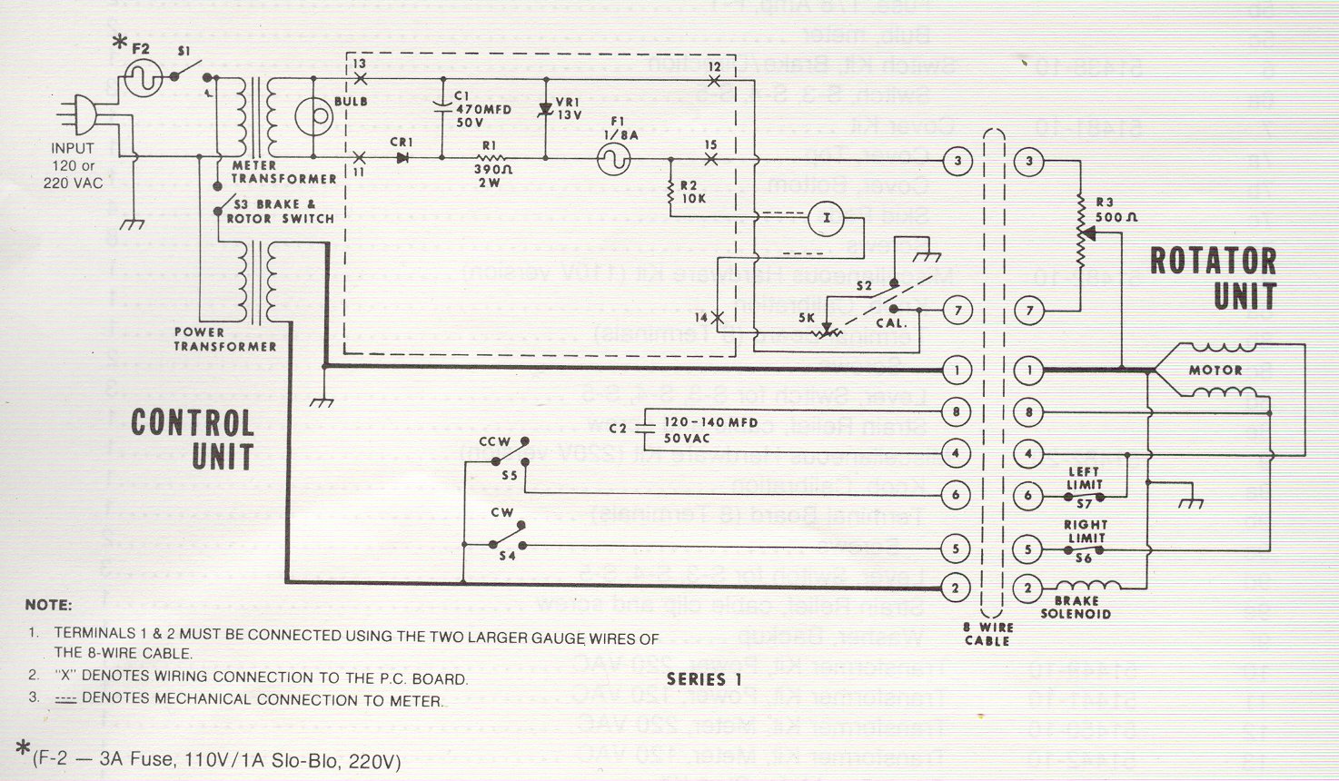

Does any body happen to know what the 2 diodes are that are in this controller/ There are 2, D1 and D2, but the manuals only give a CDE part number.
1 is listed as a zener, and another a 100 PIV diode. That's all the info on it I can find.
Thanks for any help
Thanks for any help
13V Zener and a silicon rectifier like 4000 series.
