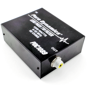

IF you have an old TVI filter from CB days still laying around - put that in line, just after the amp - and check SWR at the radio...it may change - because the antenna being longer - being the problem, isn't going to change its' lengths or add capacitance, but the filter inside the TVI unit, can see there is a different impedance - so therefore present (exhibit?) a different impedance to make the SWR change to what it is (What you see) when you use it in line - past the amp.
I only hope that TVI filter is rated for the WATTAGE your amp will put thru it.

Can you spare a pic to show us that filter - lots of members out here - one or two may know how to help you in aligning that filter.
In my efforts with "filtering" - there were several ways to "fix" goofy SWR but it never truly made the system any better - you were just "less worried" about the radio blowing it's finals. Hence the "Tuning Stub" methods. They helped when I was in an Apartment complex and needed to fix TVI problems. It's not a cure all, but if you post a pic of the Filter - you may have several "wave traps" in there for fine trimming or "notch filter" for specific TVI problems.
