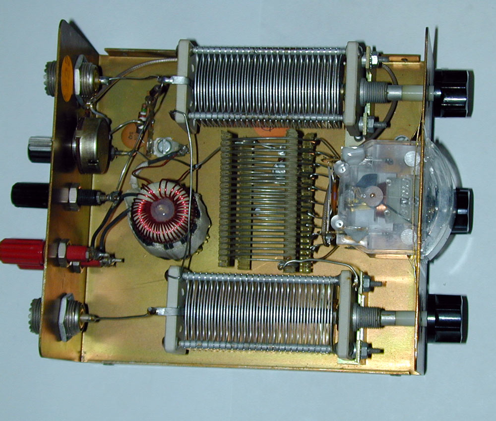

Booty: You might consider just "Bread Boarding"(building) your first tuner. They are really quite simple...The PI network is a good all around start...or the Simple "L" network works well and can be just what you need for minor adjustments using coax feed antennas. Granted not the most effective design,but simple to construct and easy to use.
I have used about every basic design,
T-Network/L-Network/Pi...etc...Presently a Link-Coupled(Johnson Matchbox) and a double "L"(homebrew) for two of my antennas feed with 450 Ohm Ladder Line.
Just something to ponder, rather than purchase...your a good builder of "Thingies"(Sorry Doc)...so now your ready to take the next step...COOL..

The best 'simple' advice for a tuner for your antenna is that it should be rated to handle at least twice the power you think you might ever use. Why? Because of how tuners are typically 'rated' for power. As in bigger numbers makes you think it'd be more capable and manufacturers take advantage of that by using 'Pep' values. It's always a nice thing to have more capability than what you need. It all comes down to 'spacing'. The space between the turns of a coil and the space between the plates of a capacitor. The narrower/smaller those spaces the less voltage it takes to 'jump' or arc over. Any impedance transformation means higher than 'normal' voltages, so think 'bigger'.
And then, the bigger those capacitors and coil are the 'wider' the range of impedances the thing will be able to handle. So the 'size' of a tuner can be a very, very rough gauge of what the thing can do. The bad part about arcing is that it always leaves traces, 'bad' spots that contribute to easier arcing the next time. Those 'bad spots' can be polished out, or fixed, but it's a lot of work.
