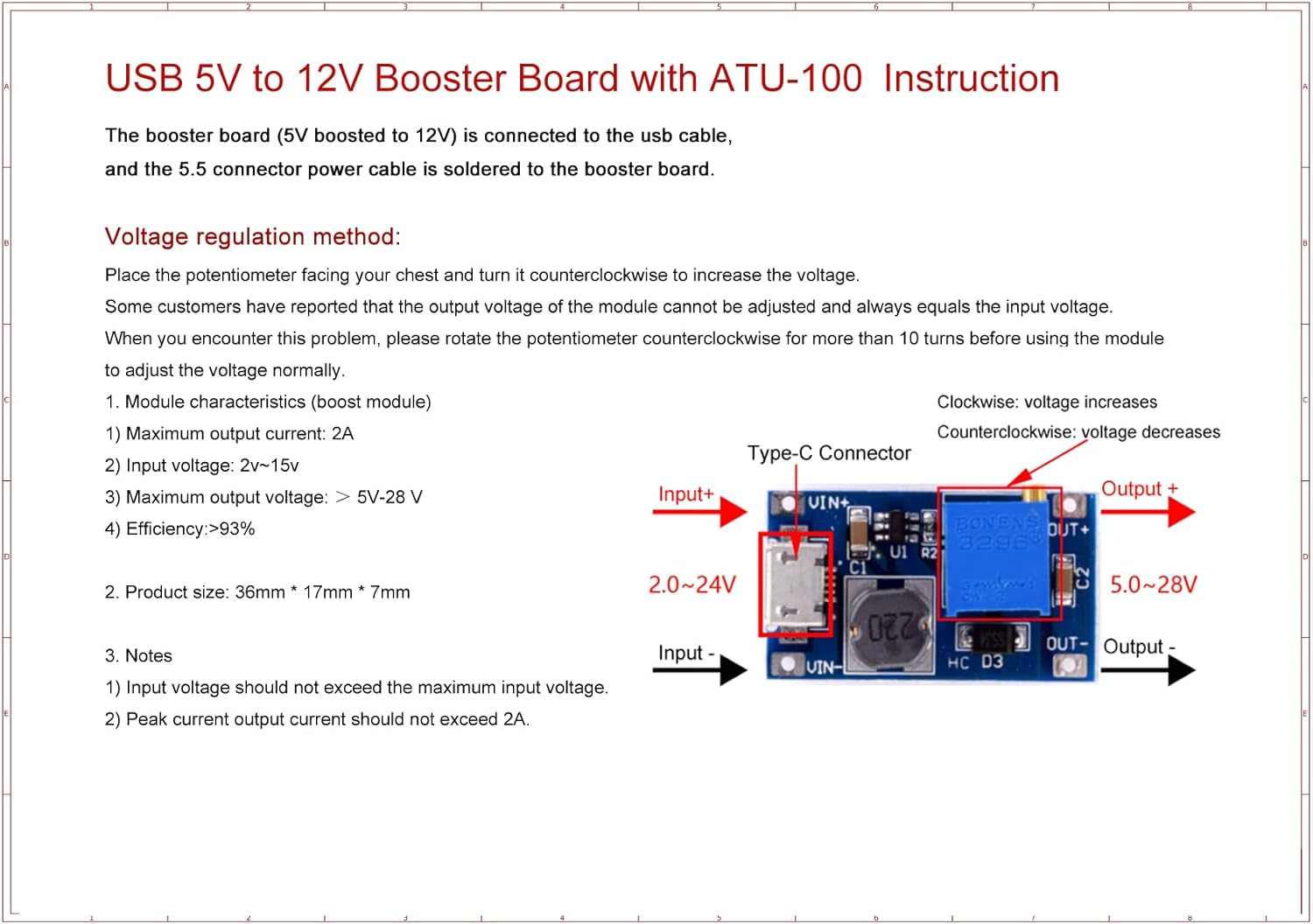

What's that little expansion board that comes with it? Is it to replace the 12 volt barrel connector and power by USB-C? Now, I wish I had bought the unit with built-in battery. I might glue a AA battery back on top of it. It actually looks like a decently made unit. Haven't tested it yet.
  • [The booster board]:(5V boosted to 12V) is connected to the usb cable, and the 5.5 connector power cable is soldered to the booster board.If you use it powered by a portable power bank (not required under normal circumstances)
  • [Note]:Do not try to be lower than 5W,Insufficient tuning may occur within 5W.
