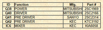

Someone told me they think this radio shares the same board as others. Also, if you know what the driver/final transistors are, kindly share. Once I get it here I can grab a few pics, just doing some research beforehand. There is some info on cbtricks although no schematic.

I've done a deep dive into this radio because I wanted to put together a capacitor kit for it. I can't because none of the vendors who re-badged the radio produced a service manual that documented the capacitors used. Here they are;
INTEK Multicom-497
Albrecht AE497
Dragon SS-497
Roadforce SS-497
Pro Star 497
Comanche Warrior
Eagle Tomahawk
Northpoint
The Albrecht AE497S has a clean schematic available over on modsdk
however, it is not the exact same. The board layout from the 497s folder looked the same as the 1000 upon brief glance so maybe the caps are the same. Maybe enough to compare to the 1000 schematic to read through some of the blurriness.
