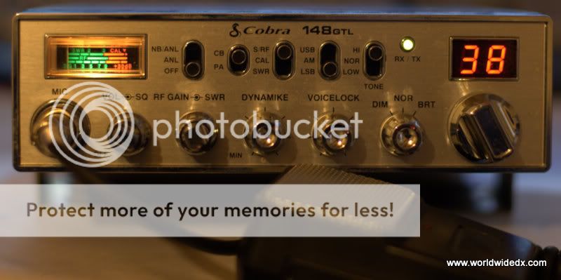

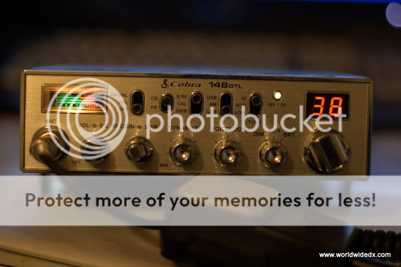

The Front Panel
Little has changed dimensionally on this rig.
The front panel has seen a number of button functions both come and go.
The same controls for the most part are the same as past 148's have. The Noise Blanketer/Automatic Noise limiter ("NB/ANL") still works well. When shut off, any car that drives past my station will upset my receive until I turn it on. It does this fairly well - with only a minimal effect on the incoming/receive audio. No better or worse than any other radio that has the same function switch.
With the stock mic, the PA functions works fine. I seldom - if ever - use this function. For that matter, I seldom use the stock Cobra mics. I have a small box full of them and give them away upon request or include one with a radio that I might sell to make the sale complete. So do may other people that buy Cobra radios. However, these radios respond exceptionally well to Astatic D104 mics - a classic combo.
The SWR meter matched up with the same results as my Dosy meter did. It was pretty accurate in that regard. The receive meter was also spot-on, as was the SSB and AM output/transmit readings. I have always liked this kind of analog meters on the Cobras; easy and clear to read and fairly accurate if adjusted properly.
The radio has the regular gaggle of knobs: Volume, Squelch, RF Gain, SWR adjust, Dynamike, and Voicelock (or 'clarifier'). They all work smoothly and function as expected. The clarifier - is of course - 'locked' and will not transmit alongside the receive when clarifying. Oh; when will the FCC change this stupid and useless rule? ANS: when enough people make a big enough fuss about it to their representatives. It has always been up to the people. Trying to get radio operators to agree on any one thing in large groups is like trying to herd cats...
They have added a 'Dim/Normal/Bright' switch on the far right side next to the channel selector. Perfect location if one was to modify for a variable power knob - if one was so inclined. The tone selector switch would also be great to use for upper/normal/lower frequency selector if one was to modify its frequency ranges. I ran the tone switch in the 'Hi' position using an external speaker preferring that setting. Otherwise, the 'Med' or 'Low' tone position was just too muffled for my ears. Note: Modilfying CB radios is against FCC regulations.
