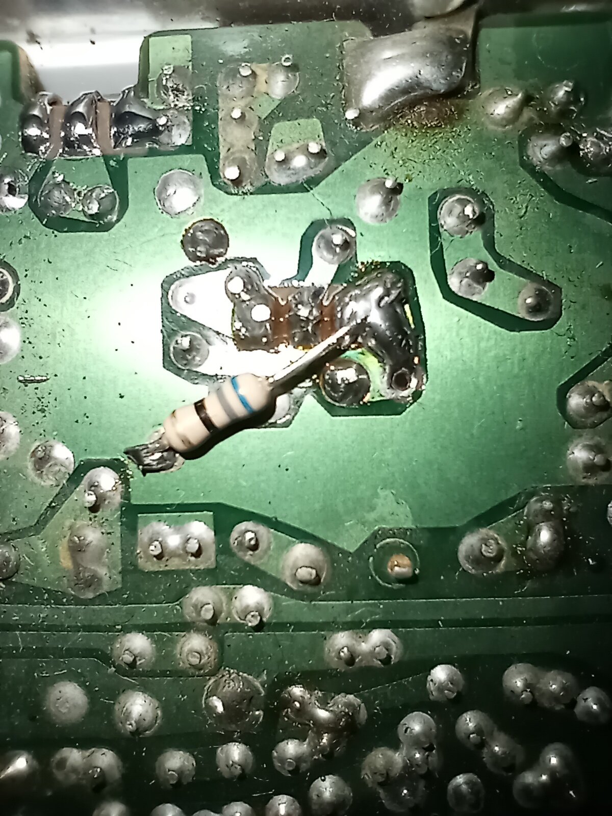

Thanks. Just one more question, maybe. This one has a 2sc3419 in place of tr37 whereas the schematic calls for a 2sc496. Now there is also a 68 ohm resistor strapped from base to ground of tr37. I don't have a driver or final installed yet, and it seems to adjust correctly with .680 VDC about midway on the bias trimmer. Voltages at this transistor are very near spec. I pulled the added 68 ohm resistor off and it adjusts from about 1.2 to 1.6vdc, way too much. I feel someone stuffed a quasi-equivalent transistor in there and added the resistor to compensate for the added gain of the wrong transistor. Should I leave it as I found it or find the correct transistor? Everything else looks good, and I tacked in a temp driver/final just to check current and wattage.
This rig came to me with 2 fake ebay 1969's installed as the final AND DRIVER with no output. I didn't have a spare 2166 for the driver, but found a nte235 in the parts bin and an eleflow 1969(cb-20). They got it back up. I see no other mods, just the tr37 and 68 ohm stuff.

Yes, 68 from ground to base of tr37, and voltages at tr37 are spec. Not exactly half way. Yes, at that position, I get ~.689 VDC at ~50ma on the base of the final, tr36.

In the post you linked to, there is mention of the Ranger TK-296GK. In that radio, the pot is 1k and the resistor is 47kΩ (instead of 68Ω). In your case, I think 68Ω is appropriate.

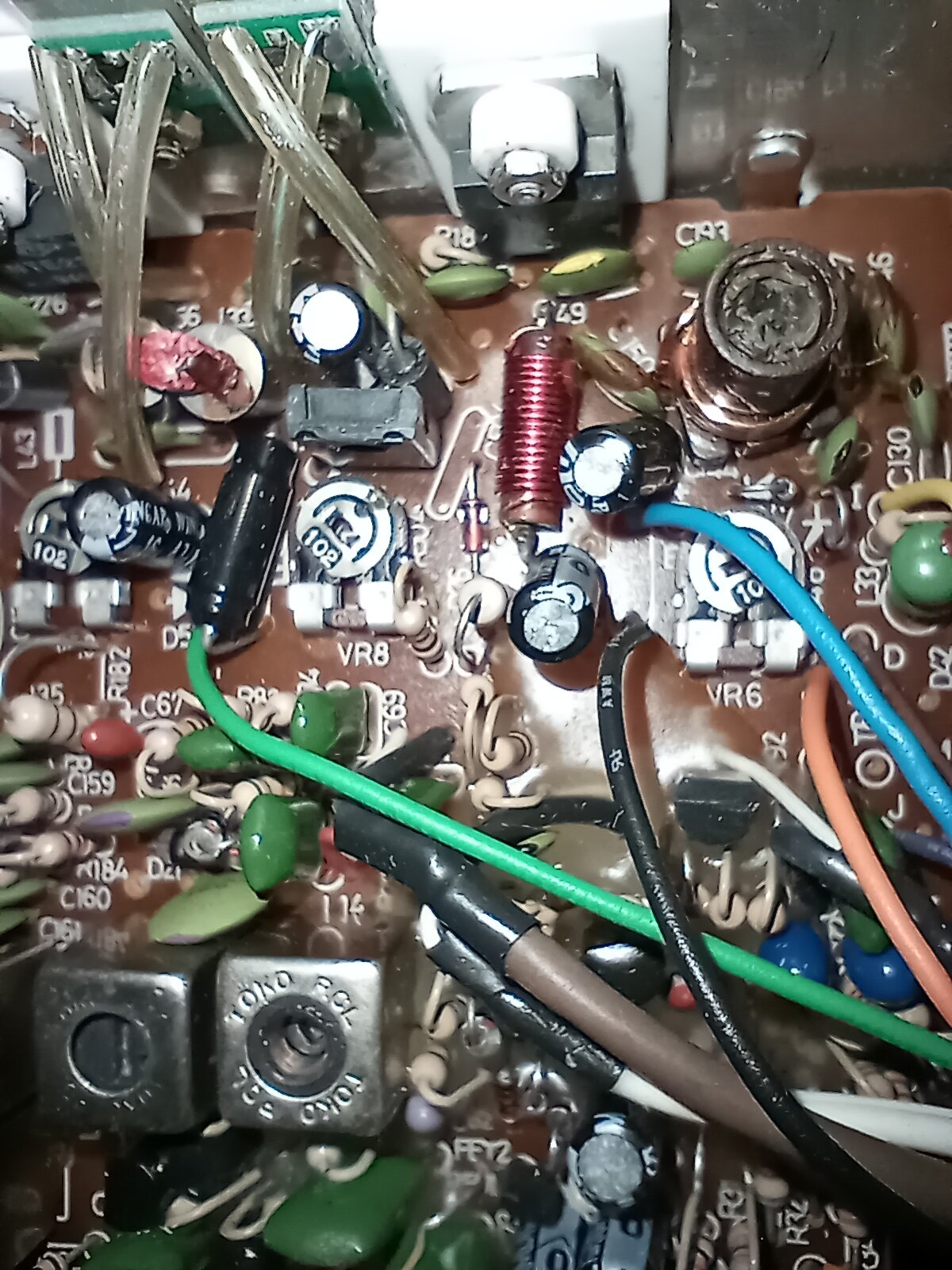

From your picture above, it appears your 1k pot is set to about 30% from the R179 (100Ω) leg, so if you have 8.3v from the regulator going into a divider made of 100Ω, 300Ω and 68Ω, the voltage across the 68Ω resistor would be 8.3*(68/468)=1.2v. If the MV13Y ever fails, the voltage cannot go higher than this.
Having no resistor there would cause the voltage at the base (and thus the finals base) to skyrocket if the MV13Y fails, burning out the final. This resistor prevents that as it ensures a failed diode cannot cause a sharp increase in voltage.
If I had to guess, i'd say the 47kΩ shown in the 296GK schematic is one of those intentional errors to see who copies their circuit. That is one of those components that can be wrong and the radio still work normally (as long as that diode holds up).
I think the reason you see so much more voltage with the 68Ω removed was due to two things, the higher current going through the diode forcing it's Vf up and no load being on the collector of TR37 (IIRC, this was when the final was out) forcing its Vbe down.
Andy also mentioned in that post to verify R181 wasn't burnt. You should do that if you haven't already.

Ok, thanks. I did verify the resistors and capacitors referenced in Andy's post and all are ok, no shorts, burns or opens, and are as expected. This radio doesn't match either schematic. So, the divider formed between the 8v source, the 100 ohm, the 1k VR, and the 68 ohm provide a voltage that varies from .5 to 3.3 volts and the mv13y provides a dual diode junction to gnd not allowing the voltage to actually reach anything above ~1.3 volts. I was assuming a 5k vr because I didn't actually look, just went by the schematic.
