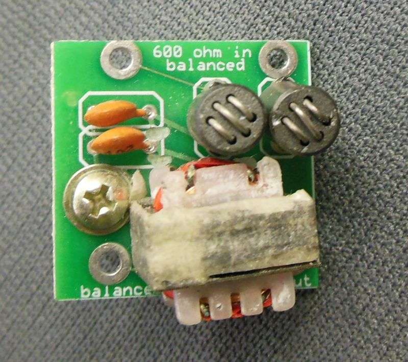

Here's what we use to prevent problems from ground-loop feedback. It's a 600 ohm isolation transformer. 600 ohm audio input and output, both.
It has RF filtering on the input side. Might help, might not. Can't hurt.
Biggest single thing it accomplishes is to couple your audio signal without creating a current path between the radio's ground circuit and the audio system's ground circuit.

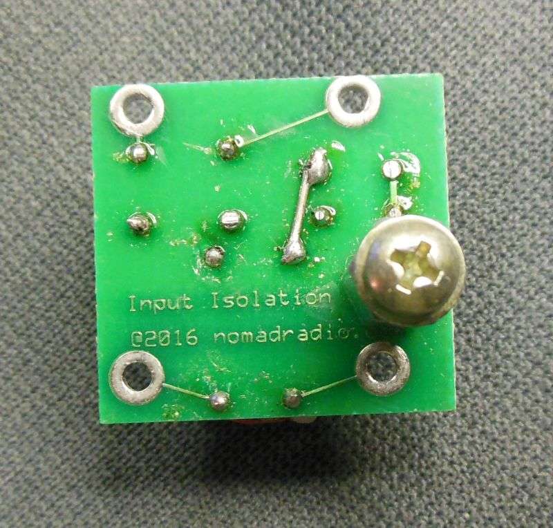

Yeah, the bottom side has a 'bodge' wire on it. Small error in the board's artwork. But this toy works.
It's a prototype, not on the market. If you want to try one, shoot me your snail-mail addy in a PM. Gotta send Dozerman a relay I promised him a week ago. Maybe I can kill two birds with one stop at the post office.

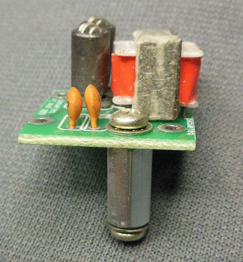

The hookup is pretty straightforward. Two pads marked "in" and two marked "output". You'll need a 1/8-inch hole in the chassis to mount it, The mount screw provides your RF ground to prevent stray RF from sneaking into the radio from your audio input cable. The mounting post must get bolted to chassis metal.
Might work without it. Never have tried.
The two output pads are easy. One of them gets a wire to C37, the other one a wire to a ground foil near C37. The nearer the better.
