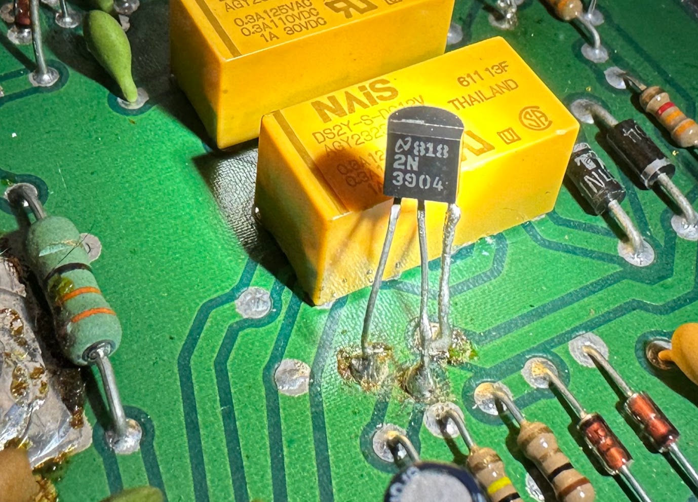

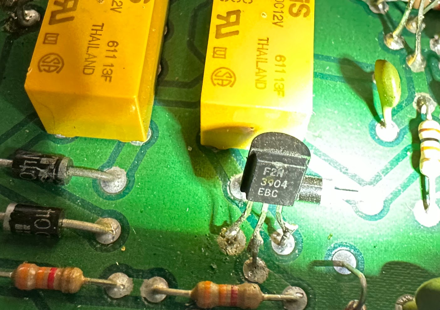

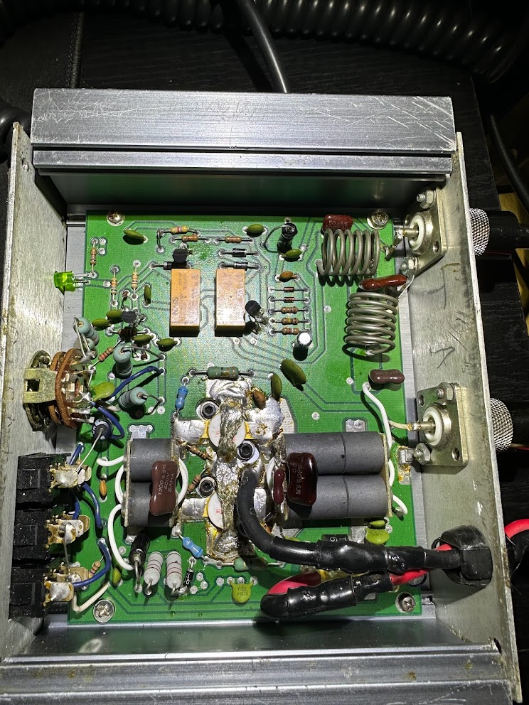

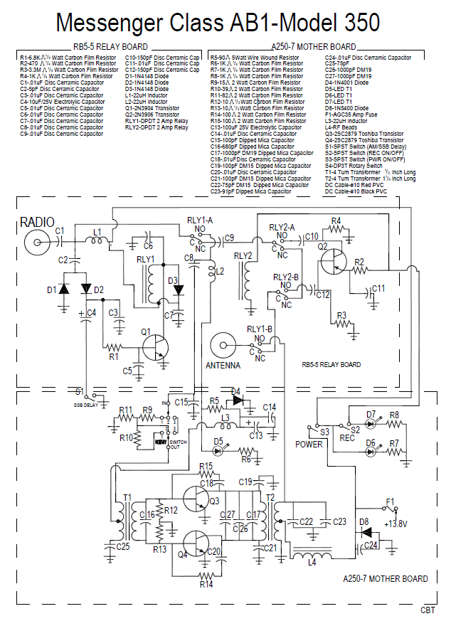

Hi, I recently acquired a Cobra XL 350 and it there are some weird things going on with it. I hooked it up the other day turned it on and I noticed that when I did, the receive on the radio would cut out, regardless of where the pre-amp switch was positioned - almost as if the pre-amp switch has zero effect. As soon as turn the amp off, the receive on the radio would come back. I opened the thing up to see if there was a glaring, obvious problem and I am not seeing anything specific. To be fair, I really have no clue what I am looking for other than discolored or burnt items. The amp has definitely been worked on as you can see evidence of soldering being done after it came off the assembly line. I figured what the hell, powered it back on and I keyed the amp up and it is definitely putting out some wattage, so the 2879's appear to be working soundly. I scrounged around the net and was able to find a schematic for the unit. I was going over everything and I noticed something odd to me. The schematic calls for Q1 to be a 2n3904 transistor and Q2 call for a 2n3906 transistor. I looked at the two transistors in question and they do appear to have been worked on post-factory, and they are both 2n3904's... Now maybe this is intentional and the way it's configured it may work as designed, but I found it weird that it's a different transistor than what the schematic calls for. Could/would that component change effect the receive portion of the amp? If not, any guidance?
I am excited to learn about this repair/diagnostic process, even though I am pretty ignorant, I am eager to learn. I appreciate any advice, thank you.
Here are some photos of what I am working with along with the schematic I found.
I believe this is Q1
And I believe this is Q2, which calls for a 2n3906

The schematic calls out Q1 as an NPN transistor and Q2 as a PNP.
Swapping to the correct (2N3906) transistor in the Q2 position may well solve your problem.

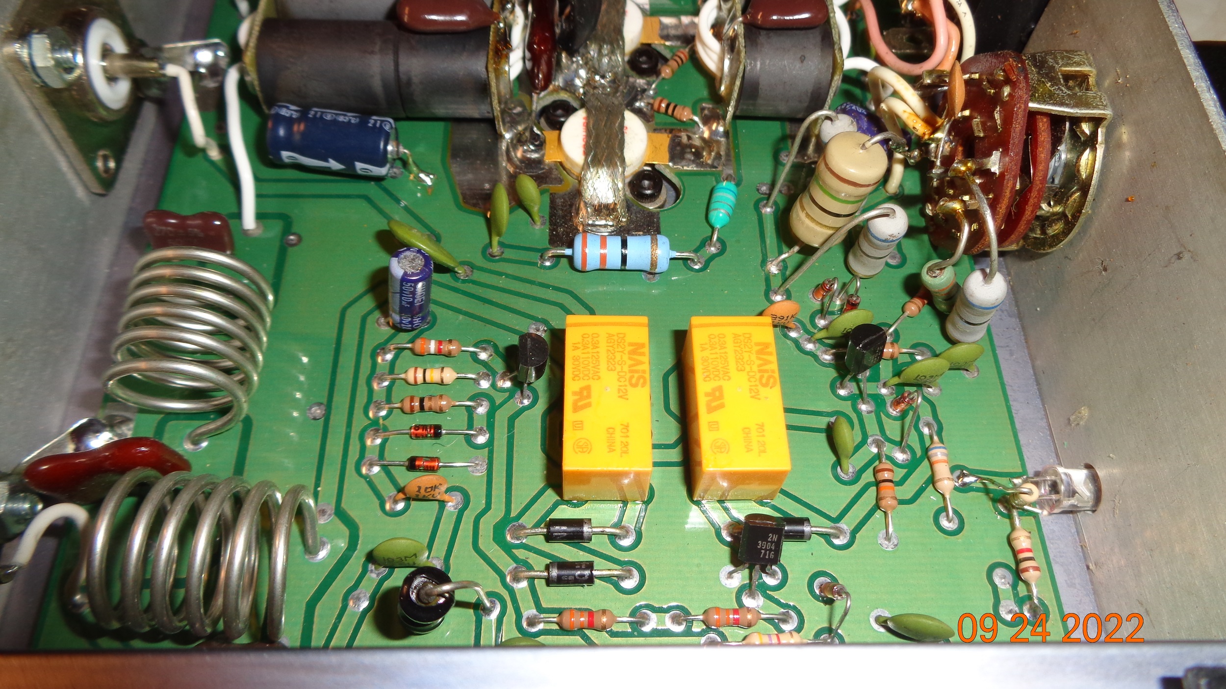

After reviewing the schematic more closely, it is not the same thing as what the Cobra XL 350 I am working with. Some things just don't line up. I ended up finding 3 transistors by the relays, not just the two on the schematic (besides the 2979's) and there are a few other odds and ends that don't quite line up.
Not sure where to go from here. I'll keep poking and prodding to see what I can find. Does anyone have one of these amps that can pop the bottom off and take a look at what the 3 transistors on the relay side are marked as?

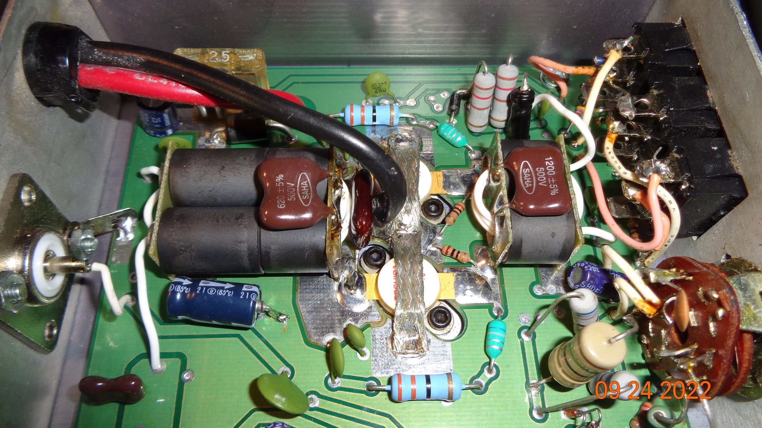

Here is an image of what this amp has installed currently...

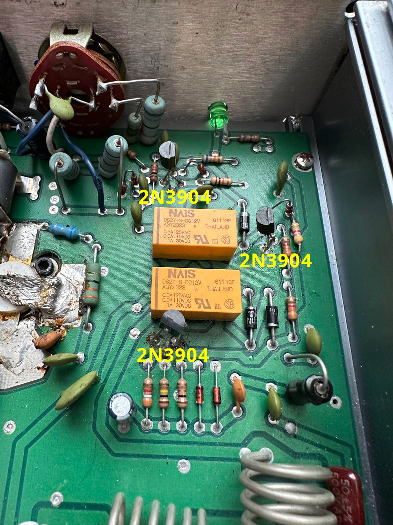

All 3 transistors are 3904 in this one of mine.
@Smokinone Huge thank you for that confirmation - that helps a ton. Even though it didn't get me anywhere near bringing this amp back to life, it is nice to know the correct parts are in there, and look to be set in the correct orientation. So thank you, and especially for adding the photos.
