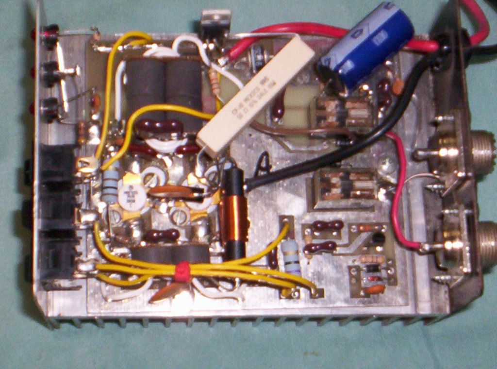

After all these years, I wish I took the time to actually hear my audio on the other end to be sure I was even happy with it. As of recent, I learned that my SSB audio just sounds overall bad on the RM Italy 203P. Best described as crunchy on the peaks. Which set me to try and do something about it.
I struggle to fully understand schematics and electronics, but I do decent on soldering stuff together. After looking at the pinned thread, I want to be sure I am going about it correctly.
This is the Comet 200 amp picture from the inside.
If I am understanding, that green resistor near the bottom-left will have to be removed and put in place a 103 (.01uh) 500v ceramic cap?

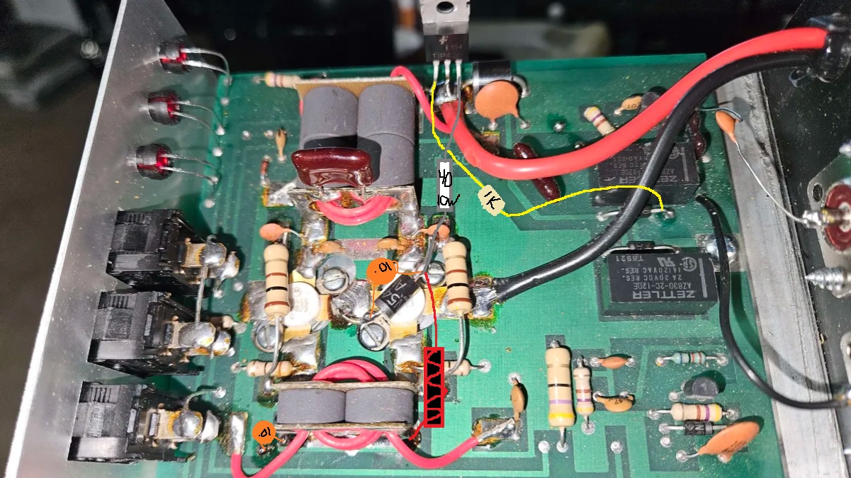

Also, I am only finding TIP42C transistors, but are those ok to use in place of the TIP42G its calling for?
I will have to Microsoft paint over the picture to be sure I am soldering stuff right. I just wish to finally sound ok on SSB.
Any help on this would be greatly appreciated. I did get this picture from the pinned thread which looks to be based off the same design.
Going to stop here for tonight. I managed to at least get the parts installed and Microsoft Painted in the missing parts I need to put in. But is this the correct way? The picture is kinda blurry from the thread, but I am assuming the center pin of the TIP42C is right on the 12v, the right pin going to the 40 ohm 10 watt wire wound, and the left leg going to the relay being a 1k ohm 1 watt resistor? Or should it be a 2 watt part?
Almost. The center pin (collector) of the TIP42 needs to be feeding the 40 ohm 10 Watt. The emitter should connect to the fat red wire. The 1k resistor will have about 12 Volts across it. The power it will dissipate is the voltage squared divided by the resistance. 144 divided by 1000 is just more than 1/8 Watt. Safe enough for a 1/4 Watt part. A half-Watt resistor would barely get warm.

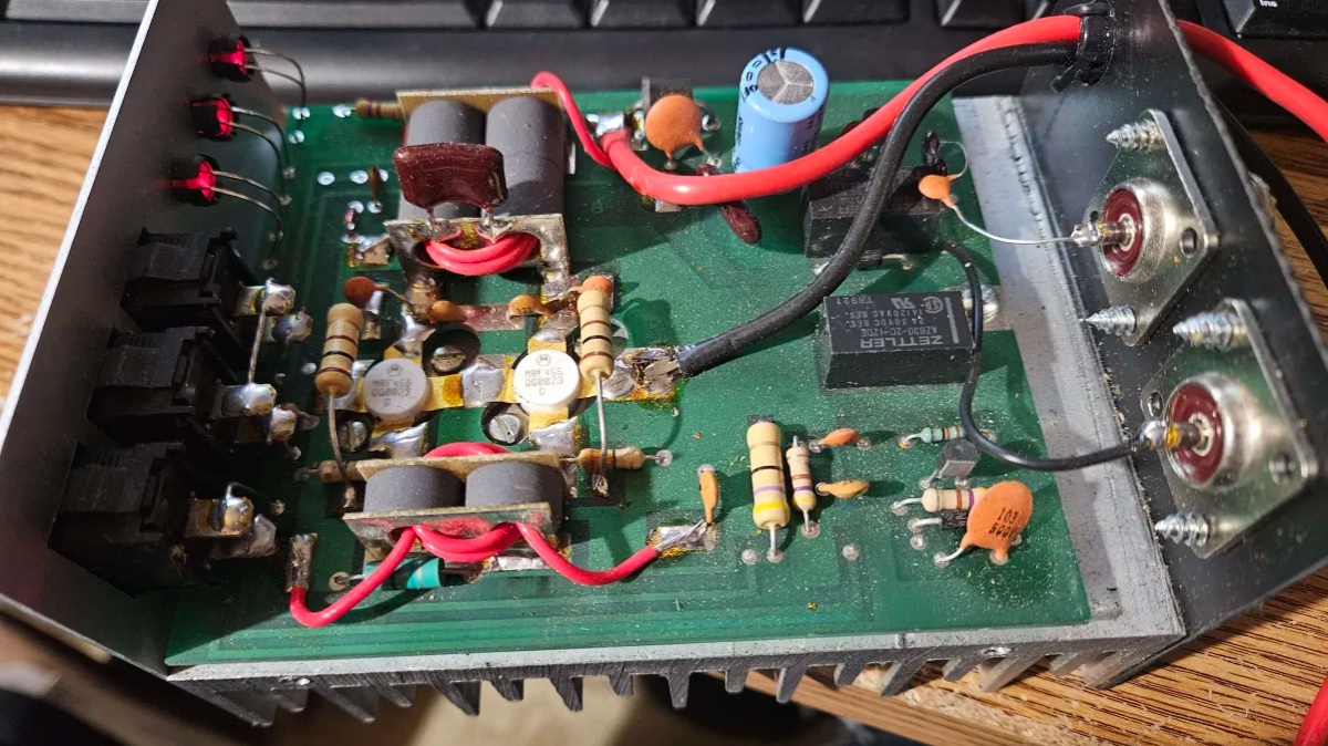

Only question for now is, I thought The Commet amp was "auto ssb" in a sense that on either mode, it at least keeps the relays on long enough to keep the relays from chattering. Thats why I removed the 470uf 50V cap while I was underneath removing the green resistor. If that is the cap where I can increase the value to the 2200uf, I can just do so from the top side. (I hope I dont have to get back under the board again!)
I included the picture of the bottom of the board to maybe help if that is what the 470UF capacitor did on the topside.
I just found it strange on the bias thread, that he had to include the 2200uf, but the picture didn't show the stock 470uf cap that shoulda been there.
