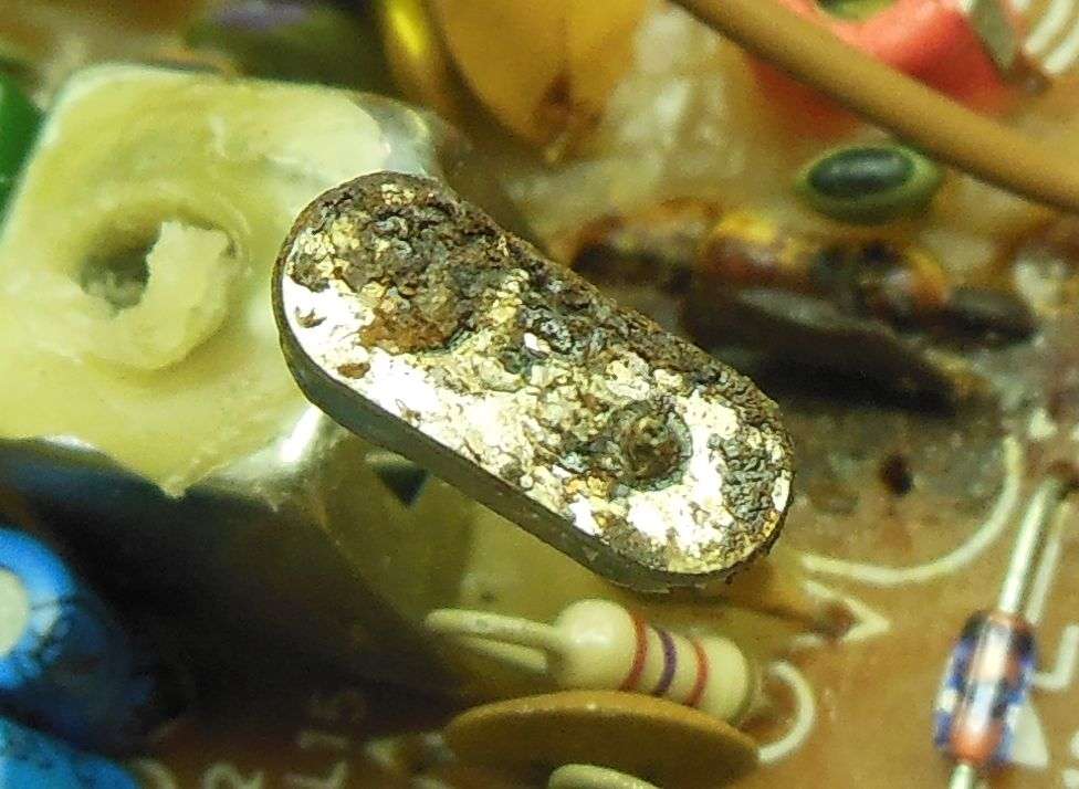

Worrying about conductive contact cement/glue in a radio is one thing.
This Cobra 25LTD went dead on the shelf. Turns out the brown contact cement they used for the 10.24 MHz crystal turned corrosive. Totally rotted the wire leads.
A new crystal and some cleanup got it working again.
Can't imagine spending much more than that to rescue a 25LTD.

I have seen a few 29xlr and the president teddy r with the same problem of rotting the legs off the crystals. I have a Teddy R in the garage right now that I need to find a crystal for. only problem is a new crystal cost more than what the complete radio will sell for.

Same problem with a couple Cobra 19 plus radios I’ve been refurbishing. Glued down wires on the print side destroyed if not weakened some the surrounding prints.

Did you try scraping all the junk off the bottom of the crystal? I tried that successfully once. There was nothing left of the leads after cleaning except two flush stubs on the surface, but was still able to carefully solder on a couple of leads. It wouldn’t take much to break them off, so I applied some epoxy afterwards to hold them tight. Again let me know later if you need any 10.695 crystals. I have a pile of NOS Hy-Gain 02A AM Cybernet boards I bought on a surplus sale with that crystal. All the crystals I robbed off of them so far have worked. In fact I swapped out an entire board with one once. I was surprised that the board needed very little tweaking. It seems all the cans must have been somehow pre-aligned.
the 36.570 crystal out of this radio I have does not even have a stub to try to solder too. it is just a hole in the area where the pin came out of it..
