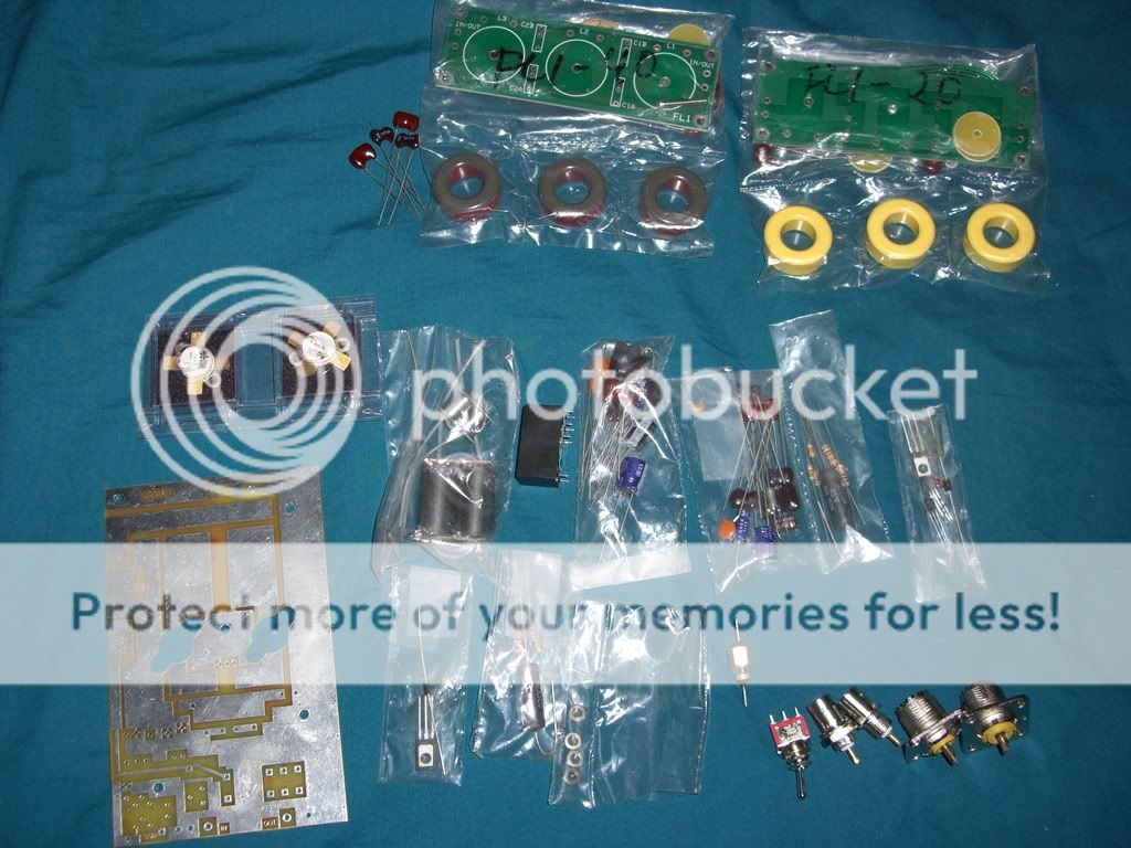

here's my newest acquisition:
A complete set of parts for the EB63 amplifier (2xMRF454 class AB), which is rated for 140W PEP output. I got it for a song ($60) on ebay.. plus as a bonus it included 2 Communications Concepts low-pass kits for 20 and 40m. Not a complete set, but way better than nothing. I can get the rest easily enough here.. I just need to get a heatsink and have it drilled for the transistors and temp diode (this might be available from comm. concepts, not sure yet).
My plan for the LPF set is to do another free-standing filter unit like my previous LPF project, using the LPF board kits pictured above plus 6 of these (or something similar if I can find it cheaper).. I'm lazy sometimes and buy modular components. A DPDT 6-position switch will control the relays.

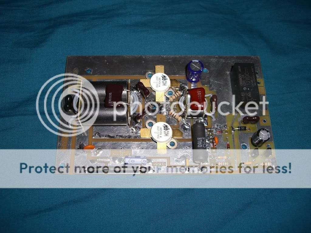

I got a lot more done tonight than I had planned. The board is complete except that the MRF454s are just sitting on the board for the photo. They won't be soldered in until the board is mounted on a heatsink.
For detailed info on the construction process see here.
LPFs are next!
I suspect you just placed the MRF-454 transistors on the board in any direction just to take the picture and the instructions will show the correct orientation. If not, you should be aware they are on the board in the reverse position and this will burn them open on power up. The cut tab is the collector and should face the larger output transformer. Good luck with the project.
^Good eye!! I totally missed that.. You are correct, they're posing for the picture only. Plus it was around 1:30AM when I took that pic. I was a little tired lol..

Things are coming along nicely.. I've added feedback to the amplifier, as the EB63 has none by design. This consists of a .01uF capacitor, 47 ohm 5W resistor and a 20uH vk200 choke on each transistor. This is untested, but should work..

Eagle, check the connection on your 47 ohm 5 watt negative feedback resistors. It looks like you have the bottom end of these resistors tied to ground. This end should connect to the base terminal on the output transistors and not ground. Other then this possible error, your work looks good.
This is an awesome build thread with great pics and helpful feedback from other members. I love it! :thumbup:
@Shockwave: Actually that's just an anomaly of the photo. The ends of the resistors connect to the little choke coils you can see there, the other end of which is soldered to the base of each transistor. The connection at the choke is actually about 1/4" off the board surface, but it looks like it's right on it due to the lack of depth in the picture Thanks for your input though.. it is highly valued!

No problem. I hadn't considered that possibility and just wanted to make sure you get the full advantage of your time and work into the project.

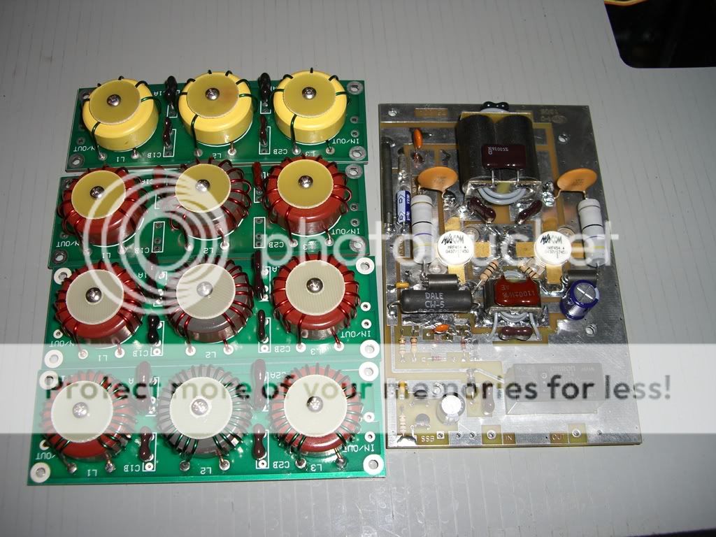

All Done!
not very hard.. More to come soon on mounting and wiring everything up!
