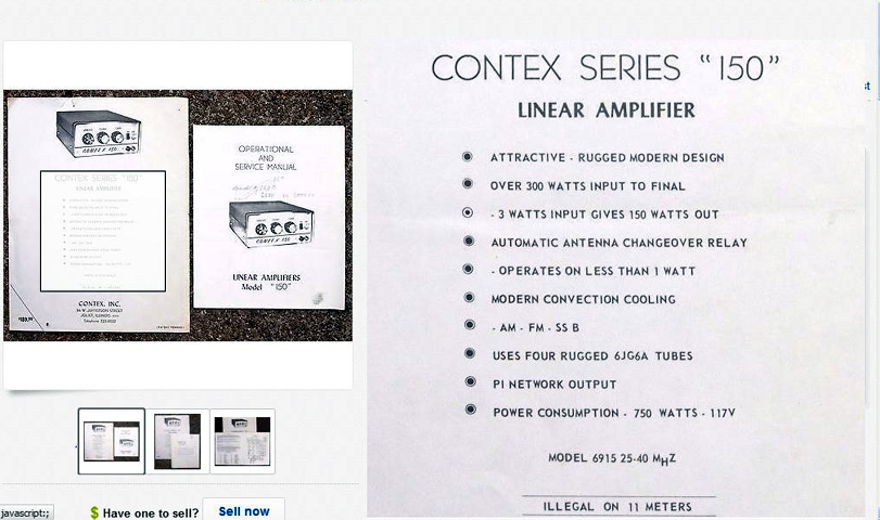

Getting back into radio..out for 30+ years. A old Ham Friend offered me a older Contex 150 from Biggs Electronics. Had to get into his attic to find it,in all the dirt and cobwebs.. its pretty ruff and covered with dirt and grime! Is it worth saving..was it any good? Any/All info on this amp would be helpful! Thank You.
