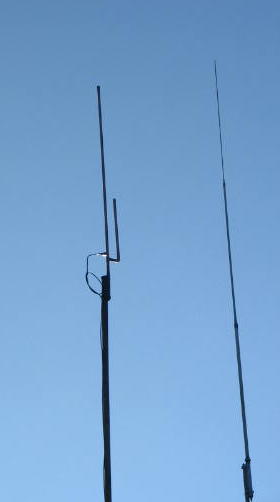

Just got this J-Pole antenna. It works great. I am picking up frequency's that i have never heard before on the Centerfire antenna i had in the air. If you are looking for a good VHF or 2 meter antenna i do suggest you get one. You will not be disappointed. Just to let you know also this is the very first J-Pole i have ever had and for a great price. Here is a picture of my two antennas in the air

J Pole antennas are just so-so. They work, but have very little gain.
For a tough antenna you can throw in a go kit, they are fine, but for your home, there are far better.

The J pole is way down on the list of good antennas. The good thing about them is that they are small and hold up good. Be sure to coil up wire under the antenna, they are known for putting a great deal of RF on the outside of the coax, they have to have a current limiting balun or they really lose a lot of range because they radiate so much RF from the outside of the coax.

Just some thoughts about a 'J-pole' antenna,
A 'J-pole' antenna is an end fed 1/2 wave vertical antenna, and as such has no gain at all. It's 1/2 wave antenna and that's the 'standard' everything is compared to for gain.
They d work, aren't all that difficult to tune, and are pretty cheap/easy to make. They will typically perform 'better' than a 1/4 wave antenna (they have a negative gain...or a loss). They typically will not do as well as a 5/8 wave antenna that's properly tuned (5/8wave has something like 1.5 dbd gain). Those performance comparisons mean that the various antennas are mounted in the same place or same height. The height thingy is a biggy.
How about aluminum instead of copper? Makes no significant differences at all. Which do you find easier to work with? And those fiberglass antennas? The radiating parts inside are typically copper (easier to solder than aluminum). No, they do not -draw- lightning! Water sealing them appears to be the 'weak' point with -some- of them.
What 'size' antenna to get? The longer (depending on how they are made) the better. The 'longer' antennas are typically a vertical array of shorter antennas (typically either 1/4 waves or 5/8 waves stacked on top of each other). They tend to have a 'flatter' and 'larger' radiation pattern, so have a better chance of hearing other stations.
All of this is NOT 'written in stone', there are a huge number of variables that will affect any and all antennas. But it's a sort of 'rule of thumb'...

All very true. I usually just grin and shake my head when some operators start bestowing the fantastic performance they get from their home made J-poles. They usually have nothing to compare it too and therefore the J-pole definitely is about 90dB better than nothing. LOL

I have to laugh when people say the JPole is just a so so antenna. I have a copper 2m jpole mounted at 20 ft above ground 34 miles to the nearest repeaters. I also live in a very mountainous location in the Blue Ridge Mountains. I have a ridge behind my house to the East approx 700 ft above the roof. In front to the West I have a ridge that is approx 900 ft above my house.
I have absolutely no problem reaching and activating these repeaters with full quieting with a Yaesu 2900 (as a base). I even hit and hold QSO's in a town that's 20 miles from me and in direct line over a 6,000 ft mountain. My QTH is at 3,000 ft, so don't even tell me a jpole isn't a very good antenna. Not to mentioned this holler gets severe wind, lots of rain and freezing sub zero temps in the winters. So far its been up 3 winters, and I haven't touched it. That's why I bought it. Its just plane Tough, and will no doubt last a very long time.
I built a 1/4 wave ground plane 2m antenna, and it performs well also. About the same as the Jpole, but its pretty fragile. The JPOLE had a swr of 1.2- 1.3. The Ground plane I built has a low swr of 1.2. Both work well, but I'll take my solid Copper Catus any day. 73
I also have a confirmed QSO of 25 miles on simplex, and that was through a very tough path of mountains , and Hollers.
It's a half wave antenna. Nothing more.....nothing less. What I laugh at is people claiming how wonderful they are when then have not really compared it too anything else other than their HT's duckie antenna. It's a good BASIC antenna but nothing special nor spectacular about it.

I have one that's been sitting in storage since I moved 5 years ago.. and I will concur with you they work well..
