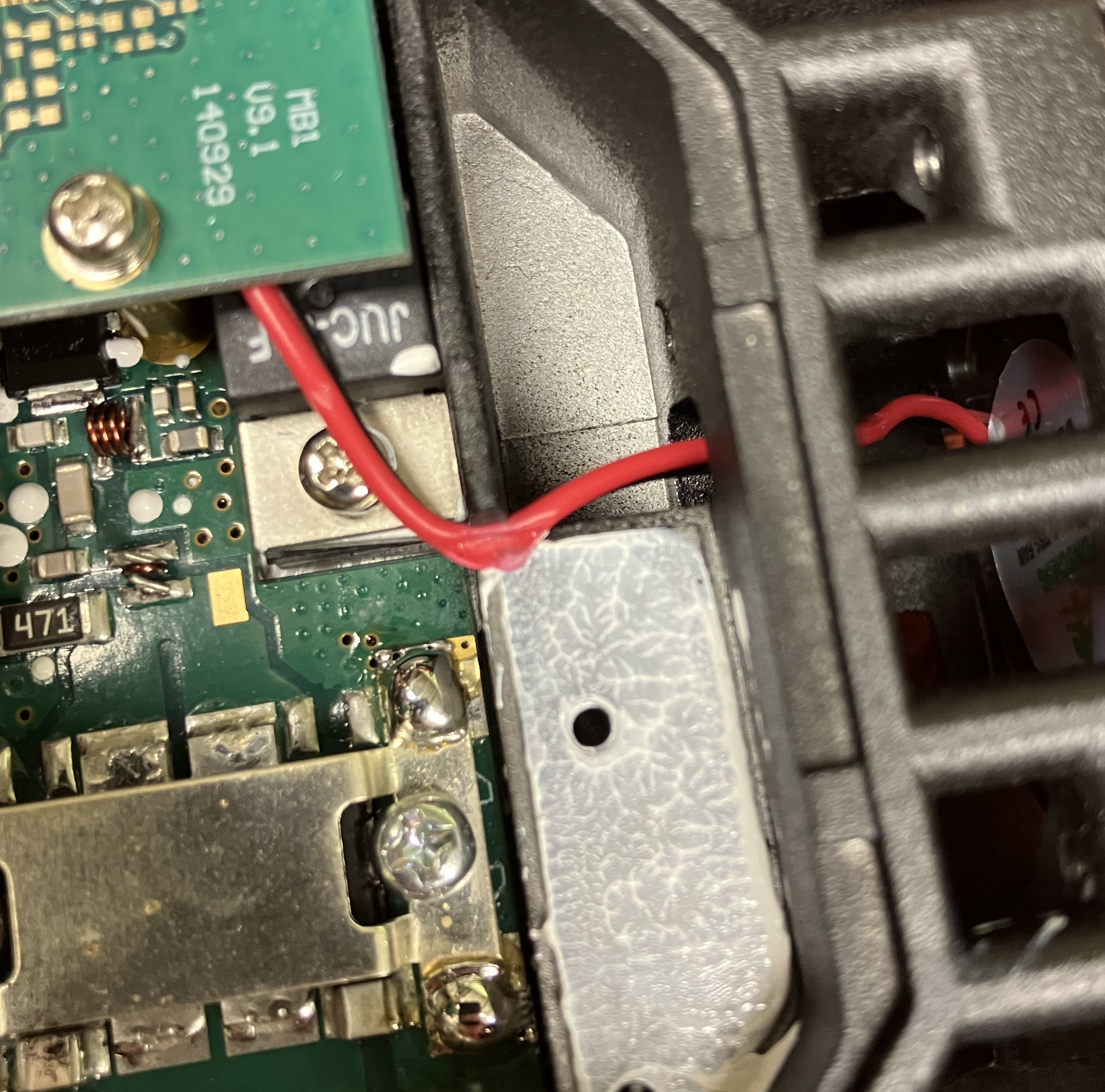

Thought I found an issue, but the fan wire is just smashed a little bit. I powered it with a 9volt battery and it spins okay.
Fan has never operated. Talked to R&L electronics and they just said it was less than 90 days so just bring it back and they'll give me another. Nice guys. Have had only good experiences with them. Next time I try it, I'll probably require a tone on the 2 meter input side (which my friends DON'T use) and just listen for 2 meter with the HT.
