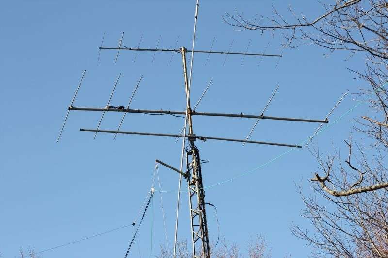

I had one, note I said HAD one. It beat itself to death in a wind and ice storm. It was the older A3 which simply meant it did not have stainless hardware. I upgraded it to all stainless hose clamps and bolts several years ago. My big beef with the A3 was that the points where the elements were mounted to the boom were not strong enough and The boom would give when tightening things down really tight. During the wind and ice storm the elements loosened and walked off the end of the boom. Here is a picture. Notice the bottom antenna has only one element. That is the reflector in the middle of the boom. The driven element and the director committed suicide by jumping off the end of the boom. Don't let this deter you BTW.From what I hear no one else has ever had that happen. It figures I would be the first. I still have it and plan to make it into a dual bander for 12/17m or possibly a single band for just 17m. I have bought a new Explorer-14 to put up when the new tower goes up soon.

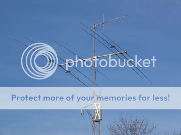

Side by side comparison of the A4S and the old TH3 mk3. The TH3 is built like a brick shithouse compared to the A4S. I'm in a high wind area and I think its time to do some serious cleaning / retuning of the TH3.
If you have a real Hygain that was made prior to MFJ owning them then I would rebuild it instead of bother with the Cushcraft A4S. You saw for yourself how much better they were made. Even the original Cushcraft antennas in my opinion were not built that rugged and since MFJ owns them now the quality has dropped even more especially with those damned hose clamps they use on the element joints. not there is anything wrong with using hose clamps it's just the the quality of thye ones they are using sucks. In the past two years I bought a Hygain Explorer 14 (MFJ) and a Cushcraft A3WS (MFJ) and ended up going to the local hardware store and buying a bulk bag of hose clamps in different sizes because the ones from MFJ would strip out. The ones I got from the hardware store were far better quality.I still like the original Cushcraft idea of the circular hose type clamps that tightened with a bolt and captive nut. No way those would strip and you could tighten the crap out of them.
