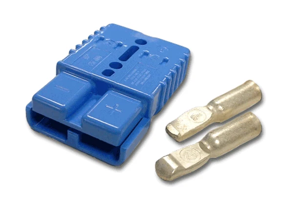

Can anyone suggest a good quick connector for DX-500?
This is what you need, Anderson connector;
https://www.ebay.com/itm/3702188055...d=link&campid=5336136228&toolid=20001&mkevt=1
Agreed. I have the red Anderson plugs on all my amplifiers. I have seen red, gray, and the blue ones pictured. If you have a butane torch it’s simple to melt solder in the metal pieces, dunk the wire and then snap them into the plastic plugs.
Reactions: Klondike Mike
Get the gray, they are the standard.
These connectors should be crimped with an industrial type crimp tool BEFORE you add the solder.
I have had to repair a lot of them and amplifiers because of an insufficient electrical connection because they were not crimped first.
You cannot get a good crimp after solder is added.
