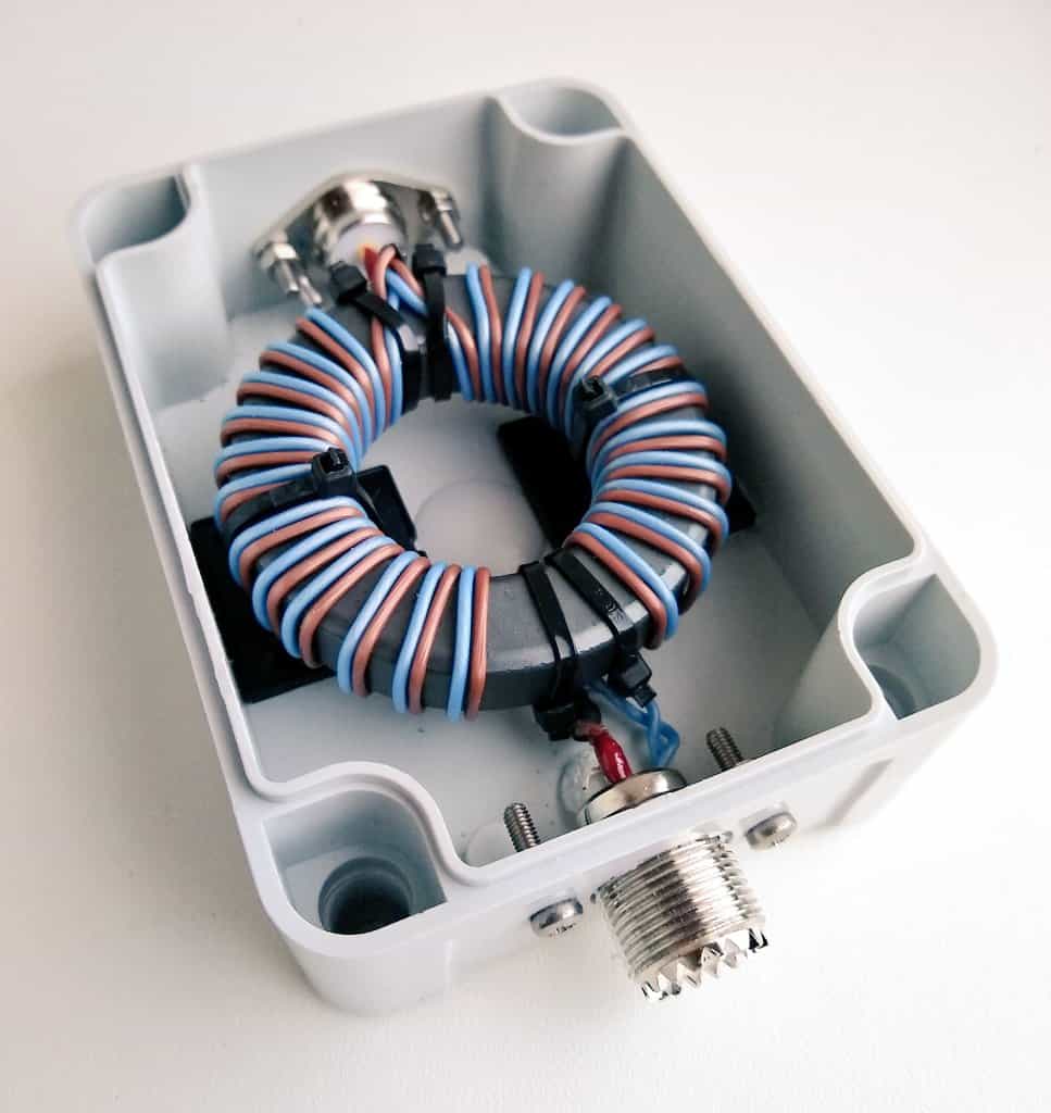

Vertical. No choke. No balun. Good match. Bad noise
So coax is part of the antenna. On RX and TX.
It is possible, that antenna is not picking the noise, but coax is.
Another thing is proximity of the antenna to metallic objects, the way the coax goes and so on.
Some reading: https://www.w8ji.com/common-mode_noise.htm
The common mode choke lowered the noise floor with 12-15 dB, equal to 2-2.5 S-points.
