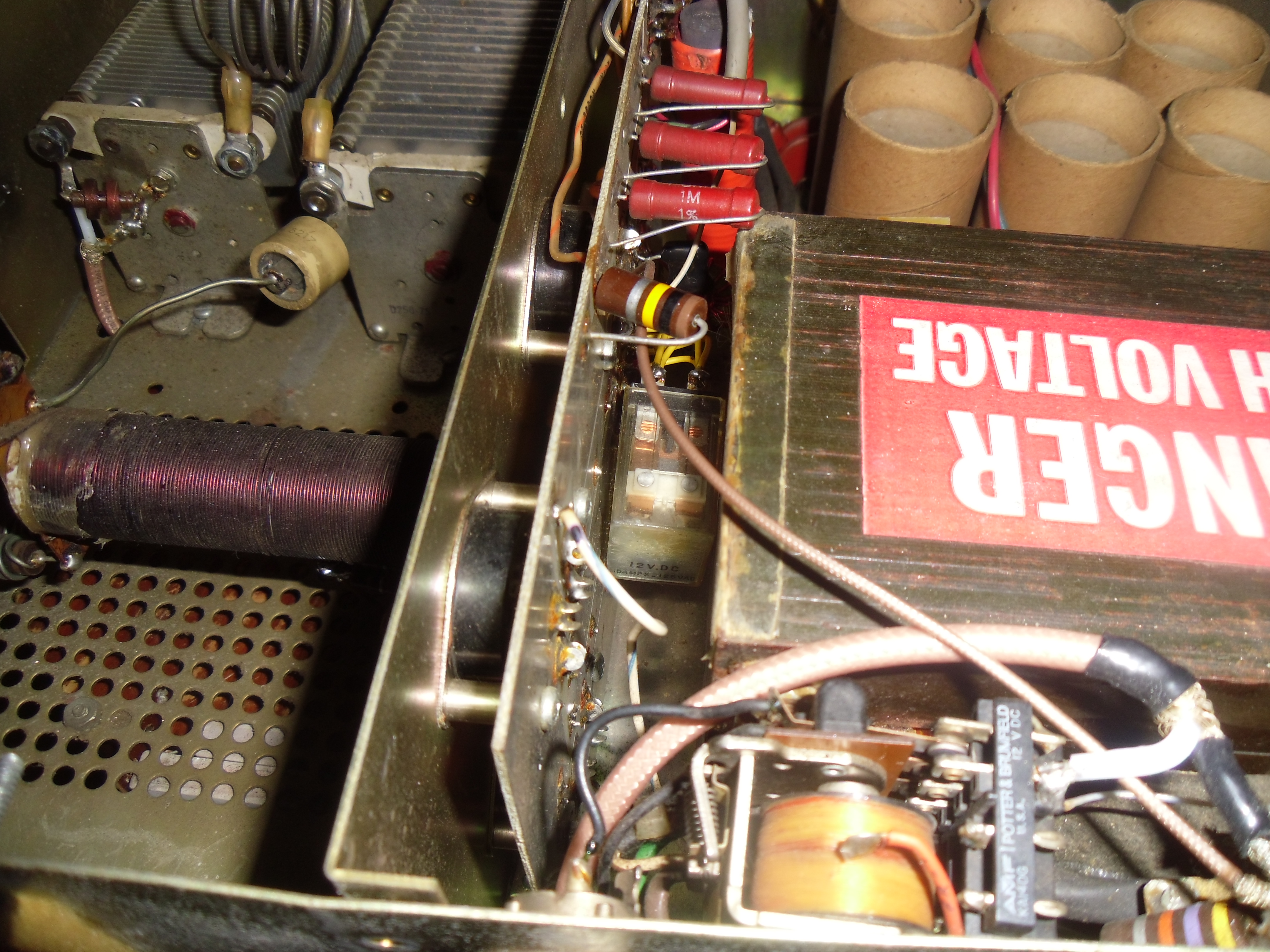

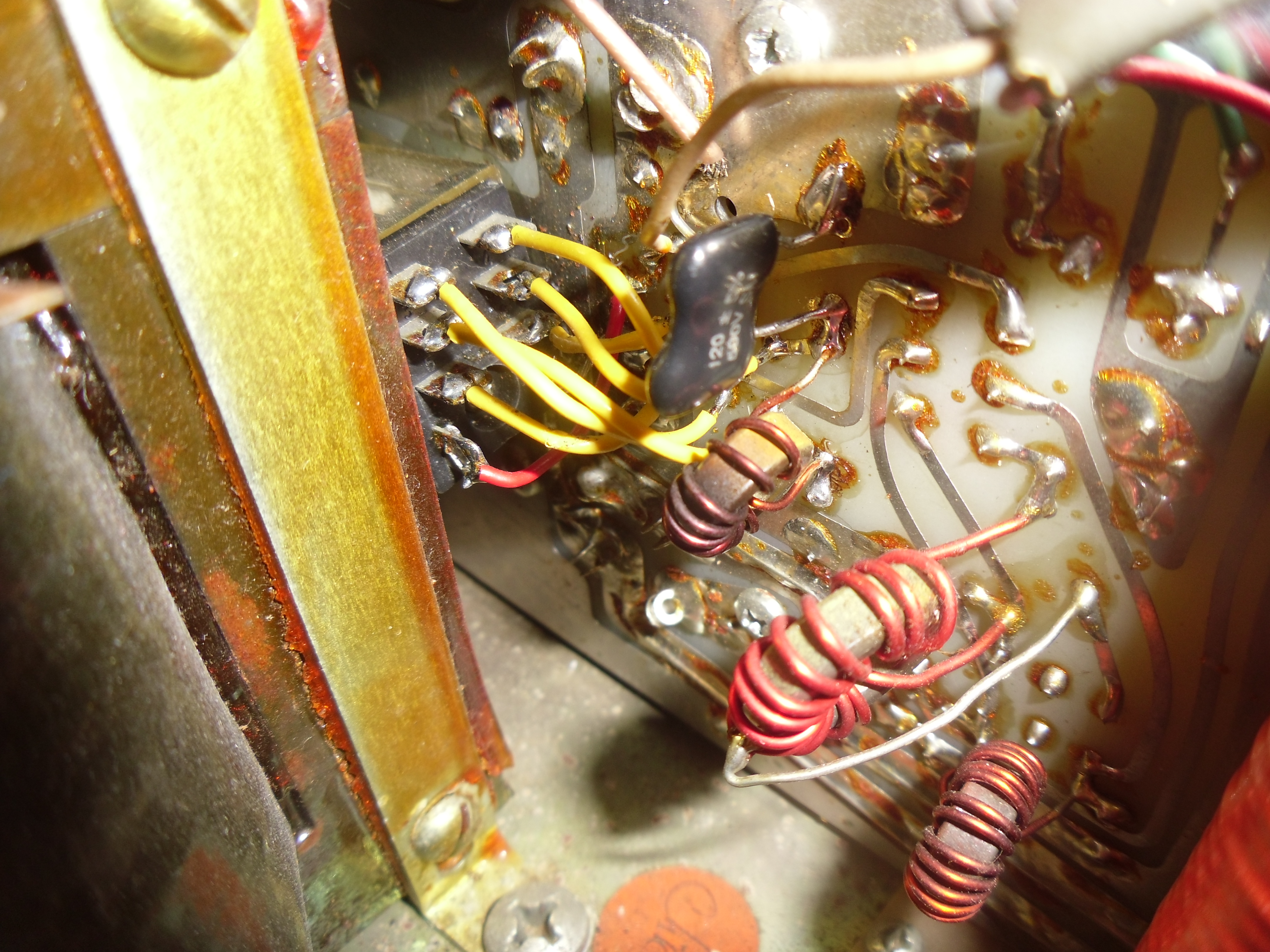

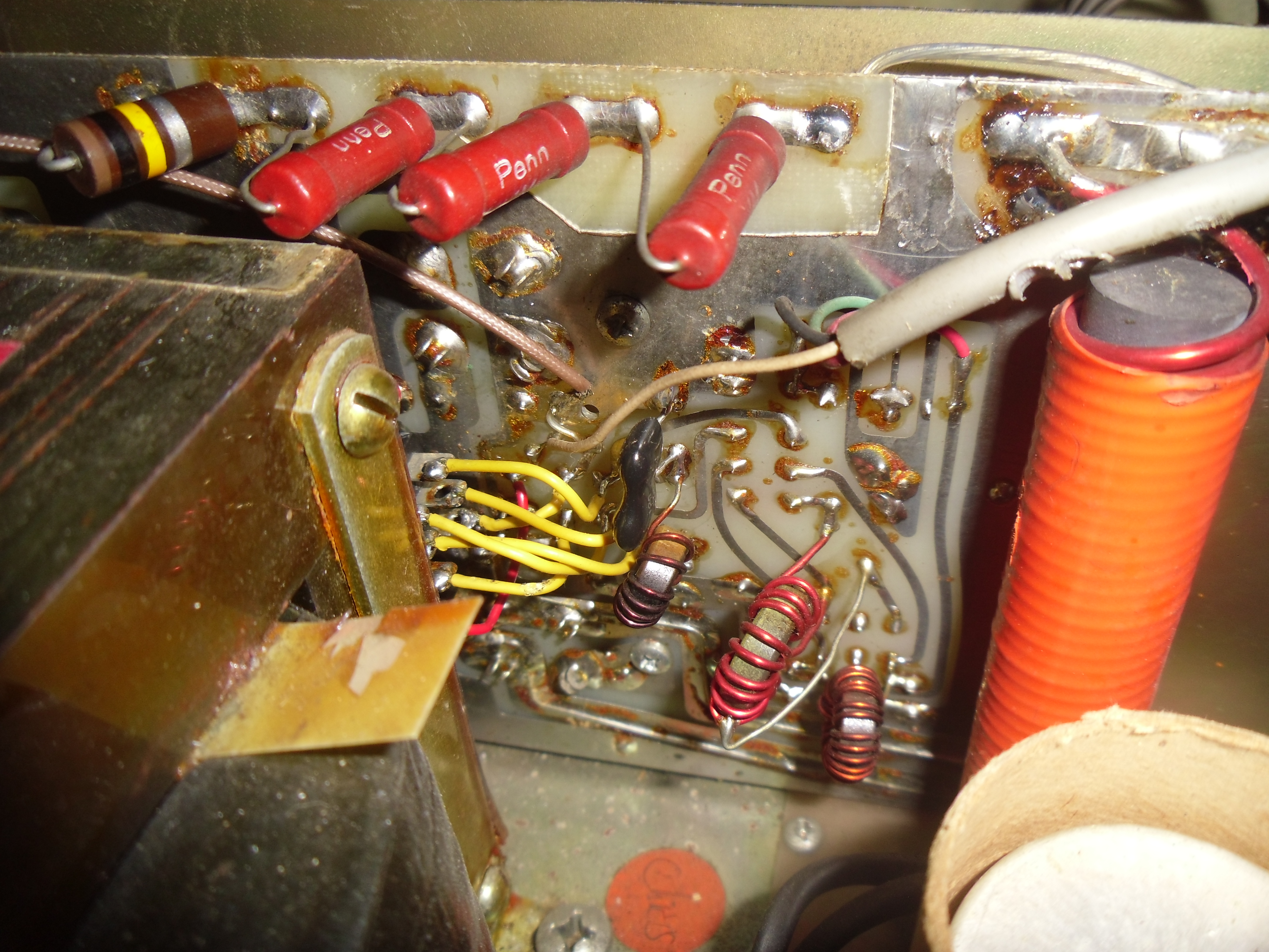

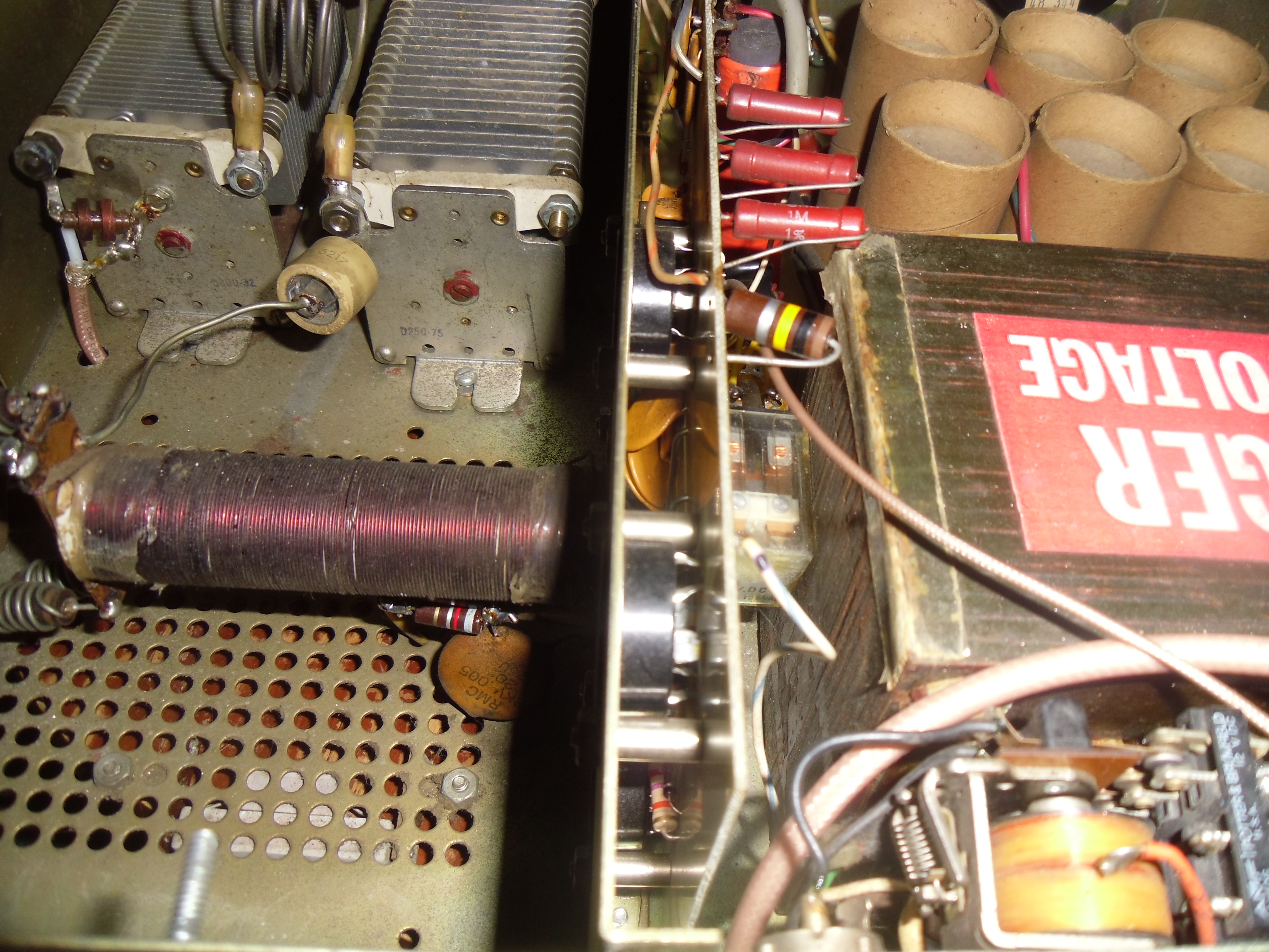

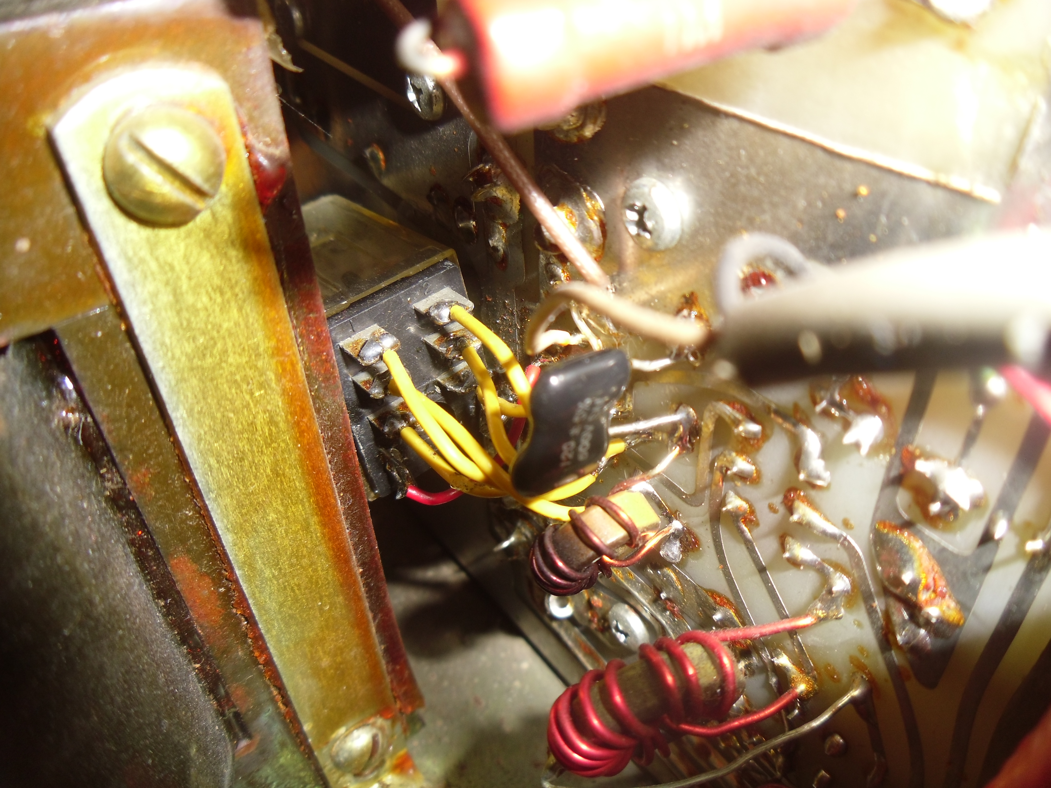

Does anyone have the schematic and or owners manual for the newer version of a Dentron Clipperton L, which has the tuned input circuits?

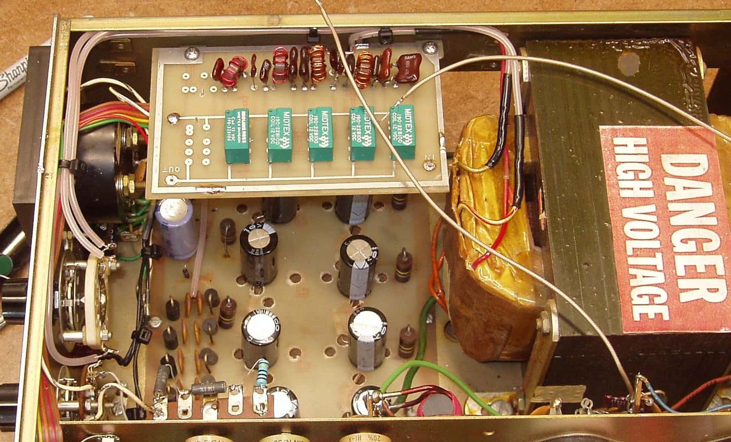

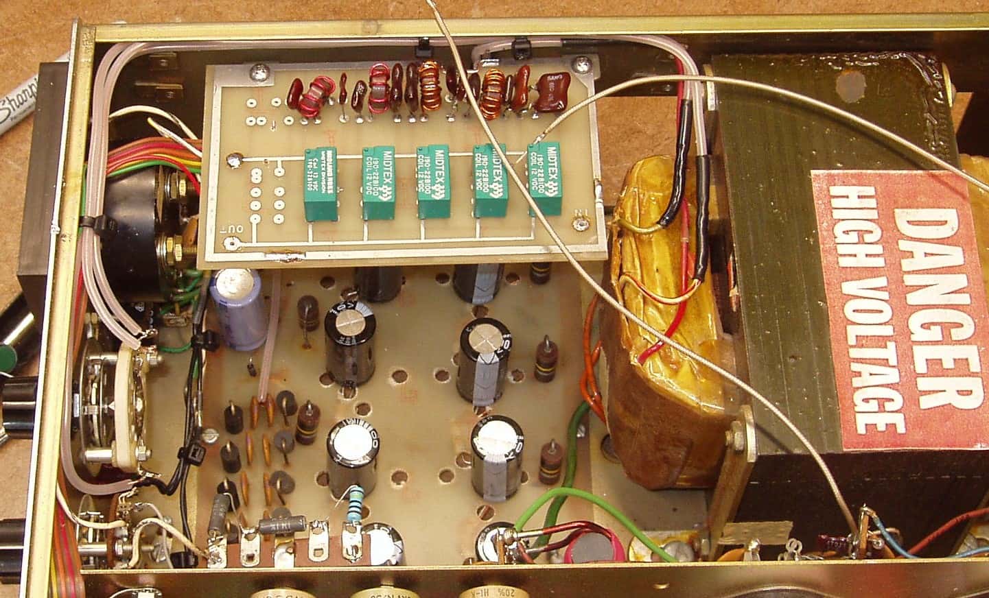

Yeah, kinda lame. But just where would you put a band switched set of input circuits? Not seeing how anyone did that right off the bat.

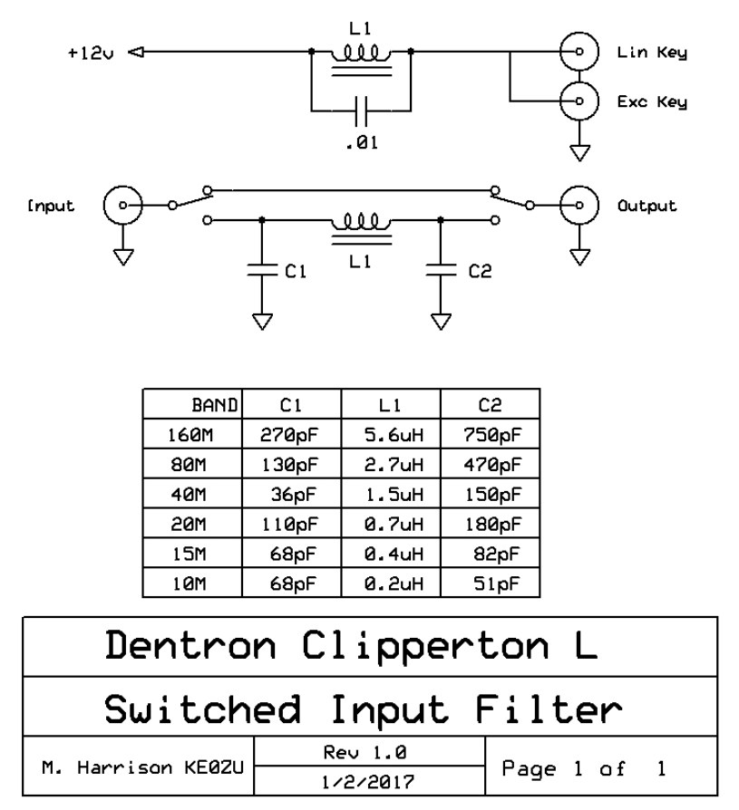

@nomadradio , here is where they squeezed it in:
As you can see the amp comes with no relay or tuned circuit for 10 meters but it does come with the info (via the schematic) of what values to use.

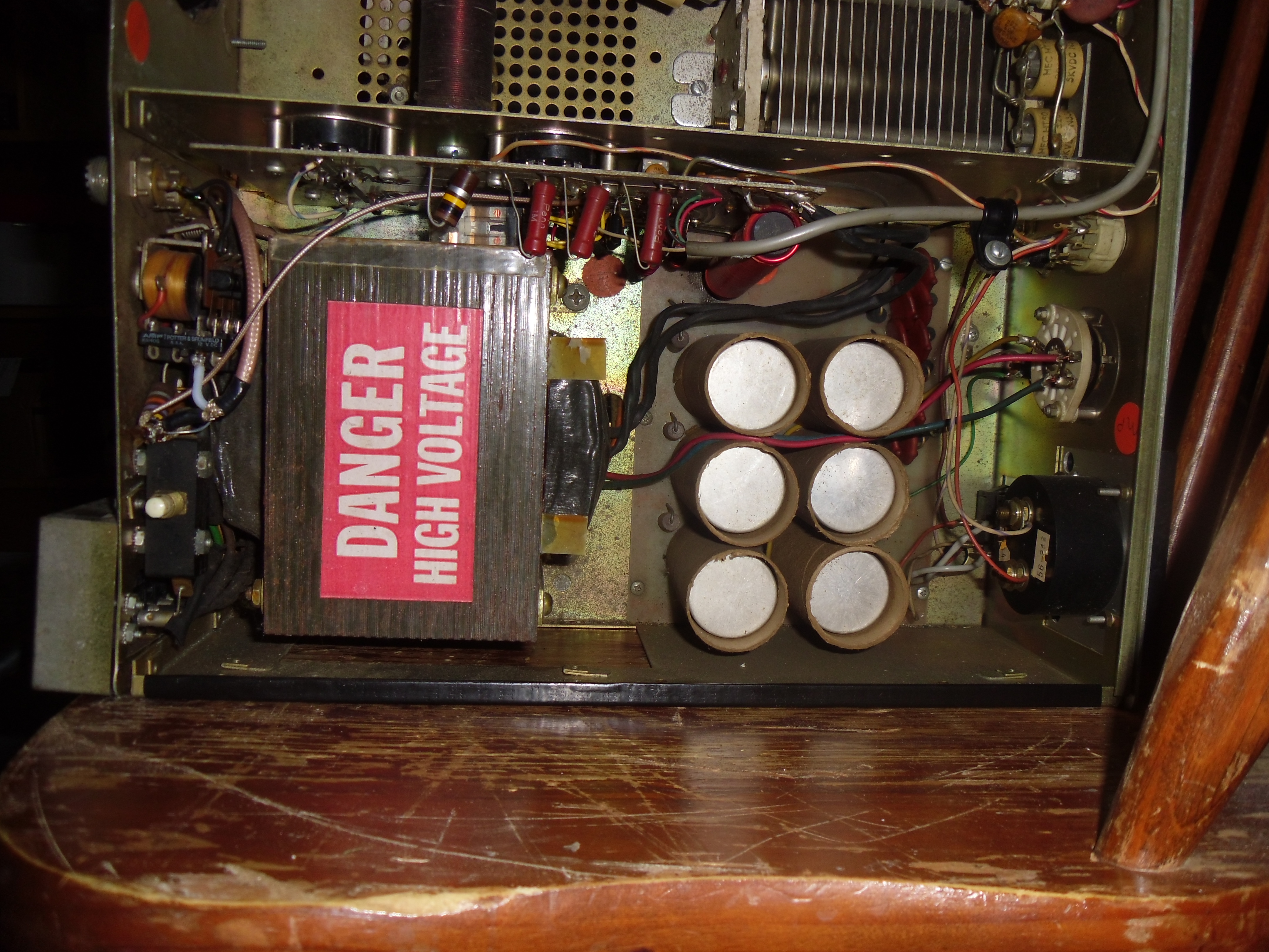

I feel like I saw this on another amplifier one time. I remember seeing a schematic where they used two chokes one to each side of the cathode and they were tied together and the b minus attached to that. Wouldn't that kind of be the same thing as a center tap on the transformer?
@314Audioman Good eye. I had a pair of 15" Mohawks in my car in 1992. Powered them with a modified Unic RV-3003 that I re-wrapped the secondary of the switching toroid for 11 more += volts on the rails while also beefing up the rail caps. It actually reached the advertised 300 watts mono after the mod. Bumped pretty good.

I've worked on a few dozen Clippertons over the years and never seen one like that. You have a rare one. Most have been untuned and 3 had that board in my previous post.
