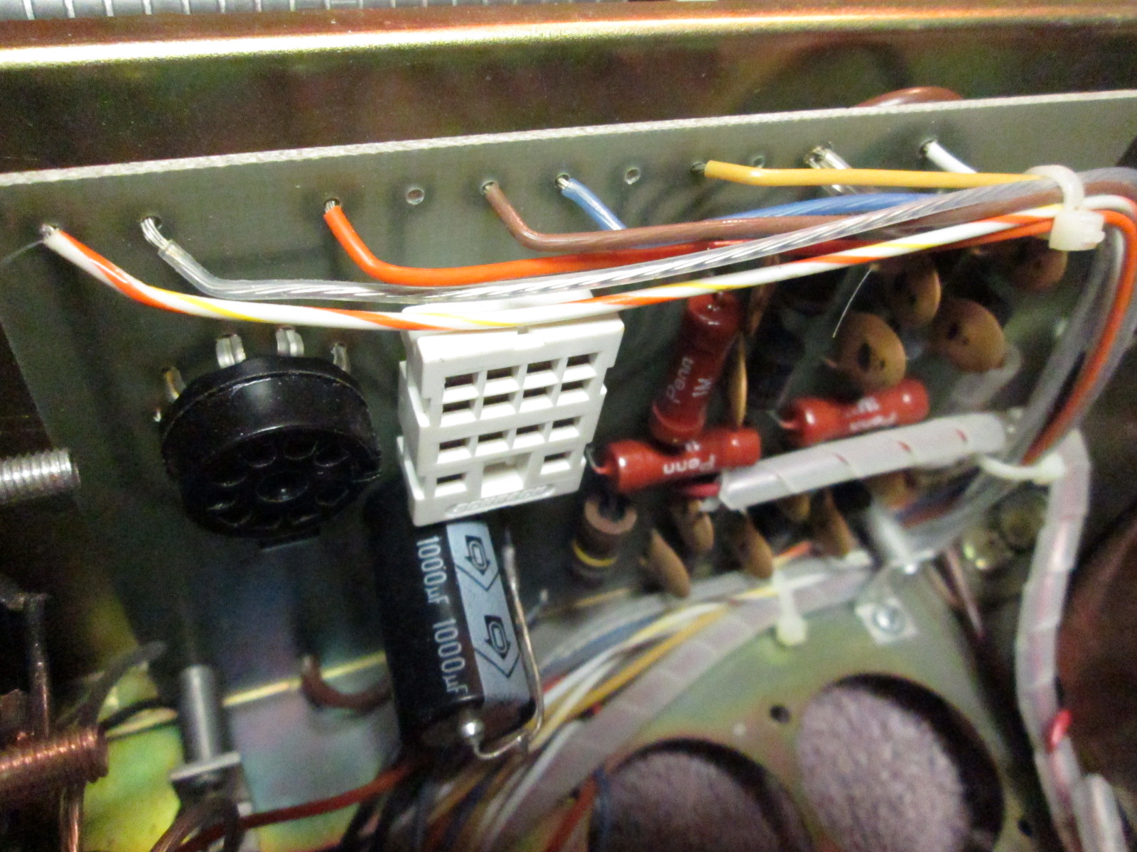

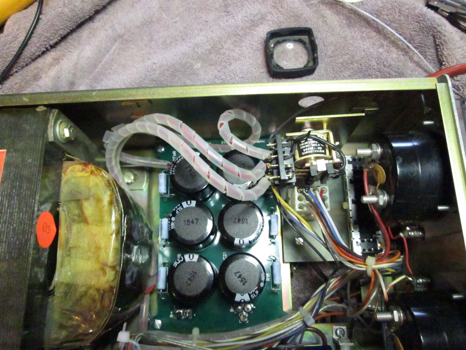

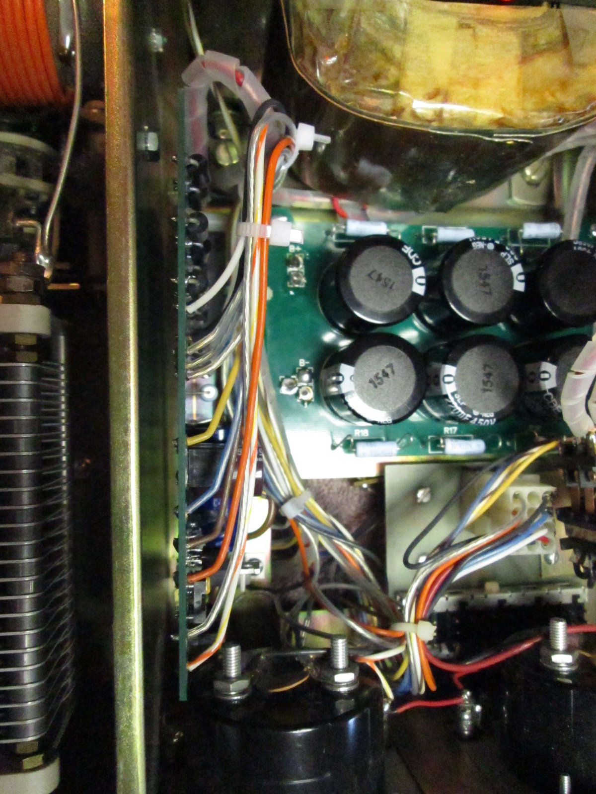

I'm doing the cap-timer board kit for a ham buddy...

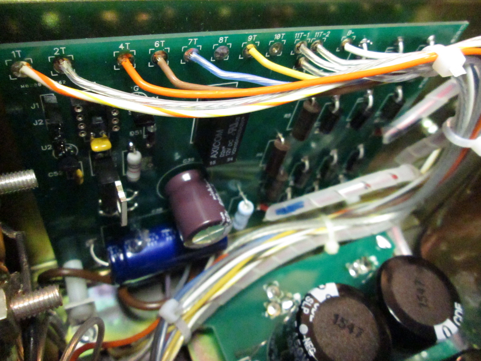

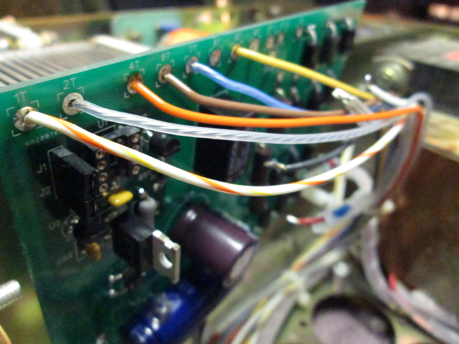

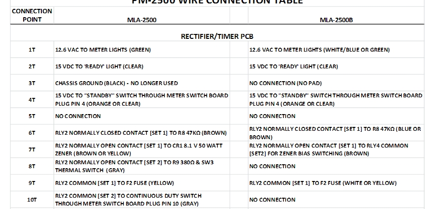

I'm ready to install the timer/rectifier board and have hit a snag.
The chart says 3T no connection and 4T says orange wire.
The original board has this reversed.
Do I just take my orange wire from the 3rd hole and put it to 4T?

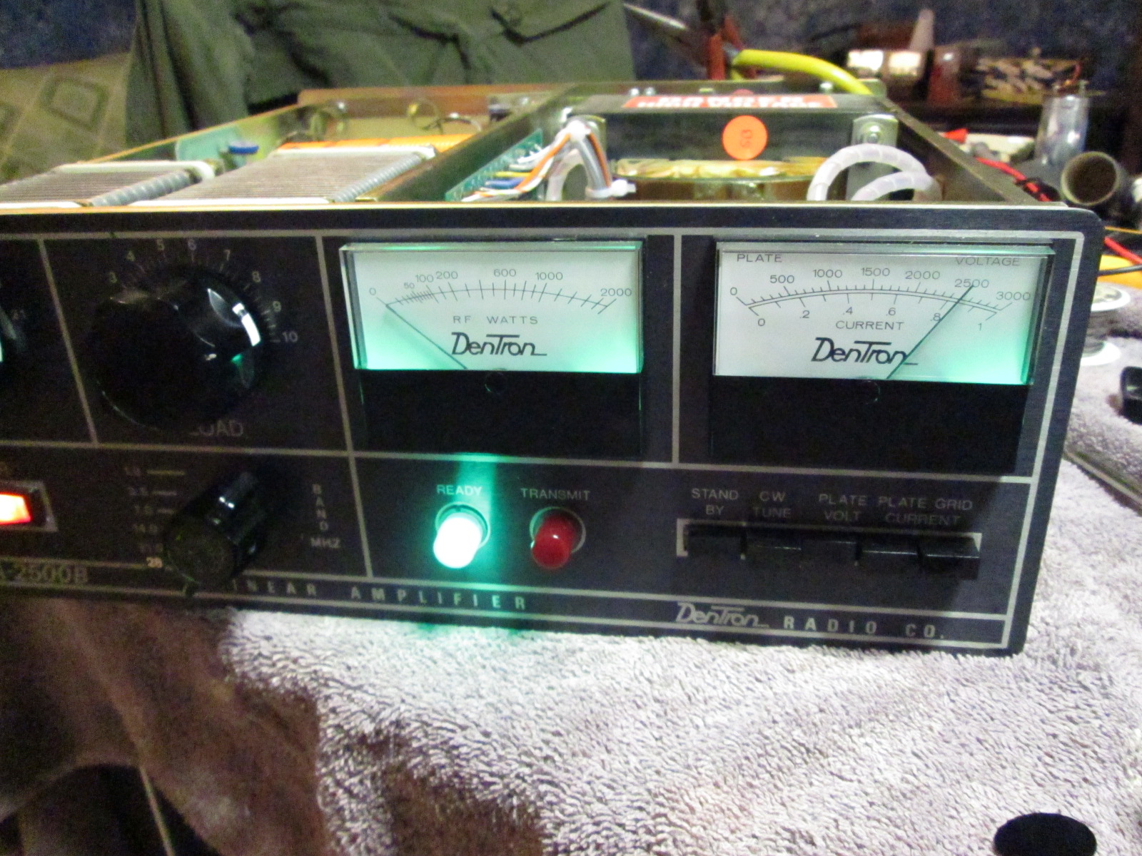

ok I think I'm getting the hang of it...back tracing and verifying each wire to be sure.
Slowly but surely.
I'll touch up that 2T wire...
