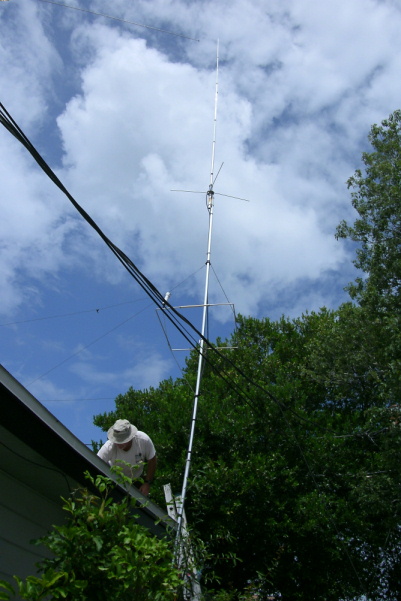

JTB-1 is a Very good antenna another antenna but not cheap is the G7-144 hustler ..
