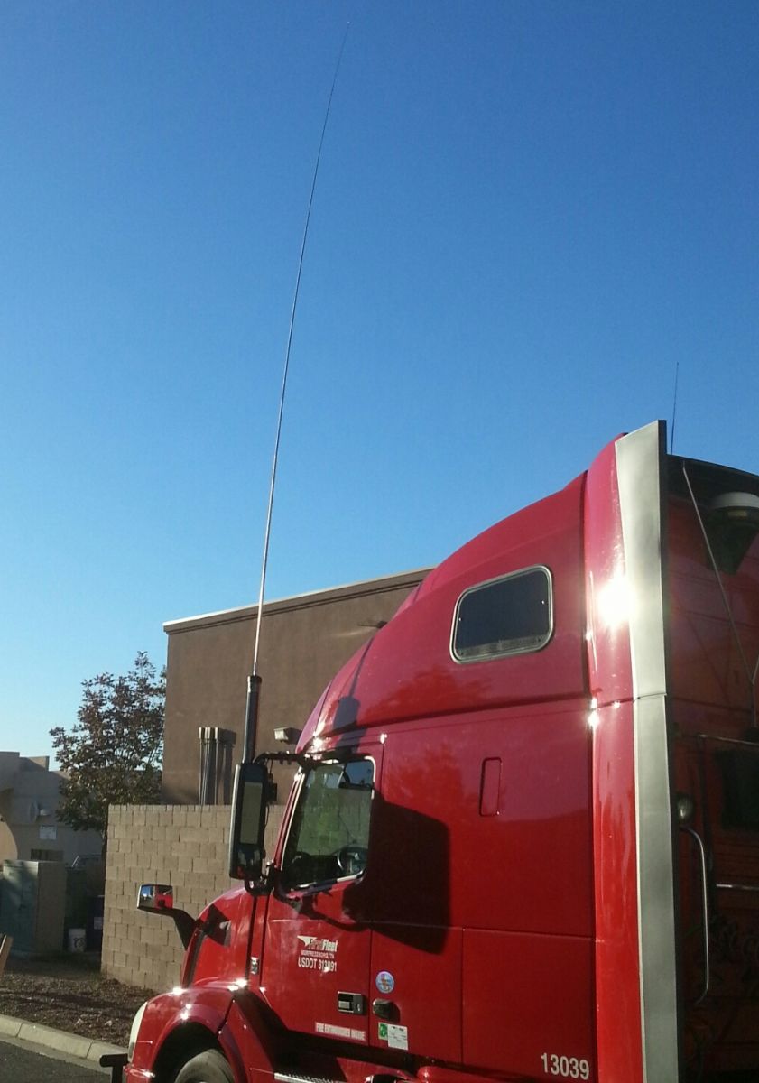

The SideKick I ran came with a 36" whip, replaced it with a 72" on
Better yet, when stationary I use a 17 ft MFJ telescoping whip. This will make a very significant difference on lower bands. The whip collapses to about 30 inches for easy storage under your seat or in trunk.

I might try this at home
You should, it really works wonders on 40m and it is a noticeable improvment on 80m. You'll have to bring it down a bit for 20m because your antenna already adds to the length plus a little coil helps fine tune it.
On my Little Tarheel, it still won't tune to 160m because the feedpoint impedance is way out but how practical is 160m on a mobile anyway?
It's the MFJ-1979 17 ft telescoping whip. (Actually 16.5 ft) that's a 1/4 wave in 20m. It's a typical 3/8 x 24 threaded stud just like any other mobile whip. I keep 2 wrenches (always use a backup wrench when removing a whip on a screwdriver antenna) handy and can change whips in a minute.
Just be sure to take it down before you go through your neighorhood MickyD's drive-thru.
