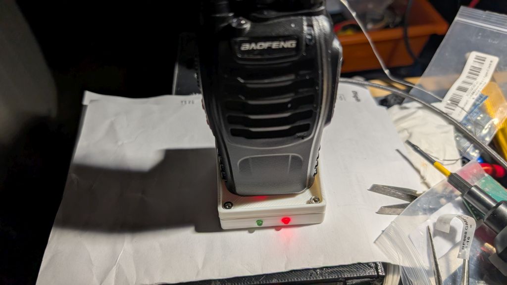

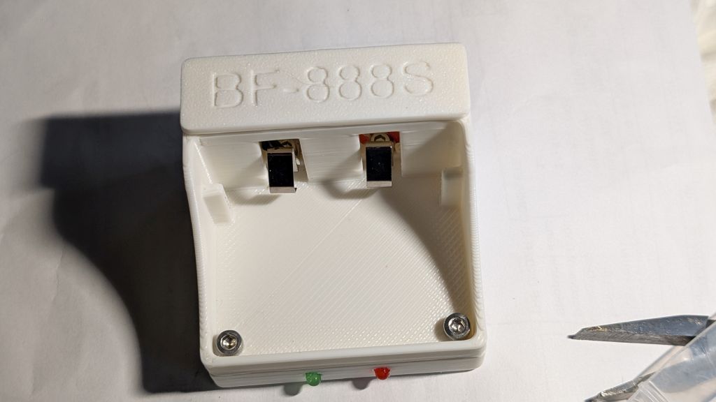

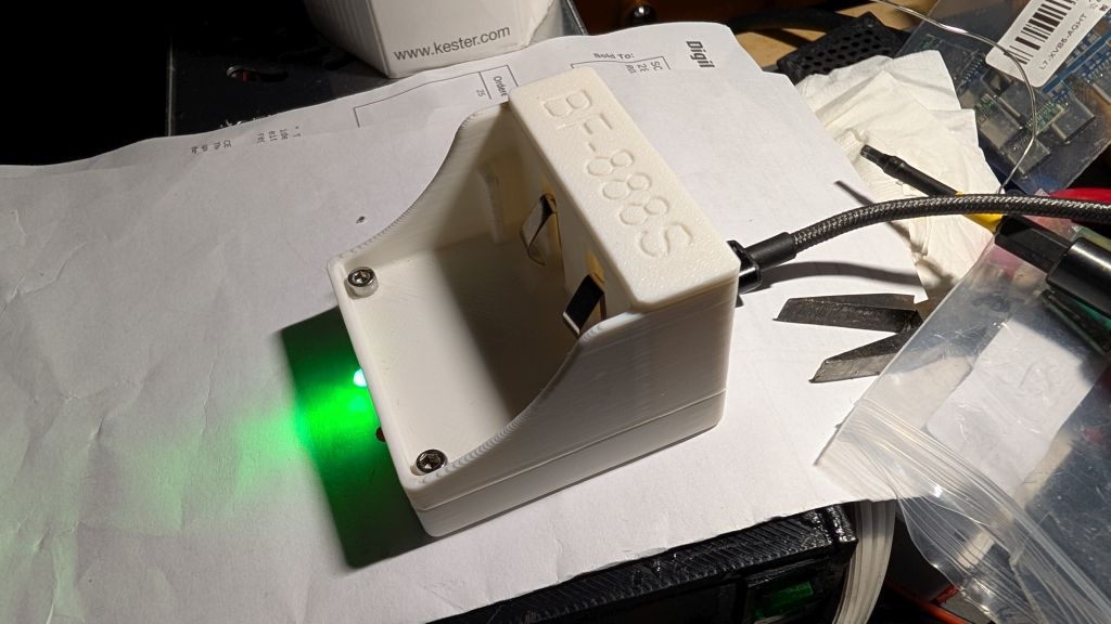

I did a couple for the BF-888S, mainly due to the OEM base being 110v AC only. The DIY version has a USB-C socket for 5v input.
Contacts used are Keystone 5321, M2.5 cap head screws hold them in place. The rest of assembly is done with M3 cap head screws.

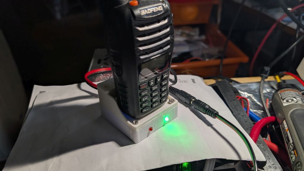

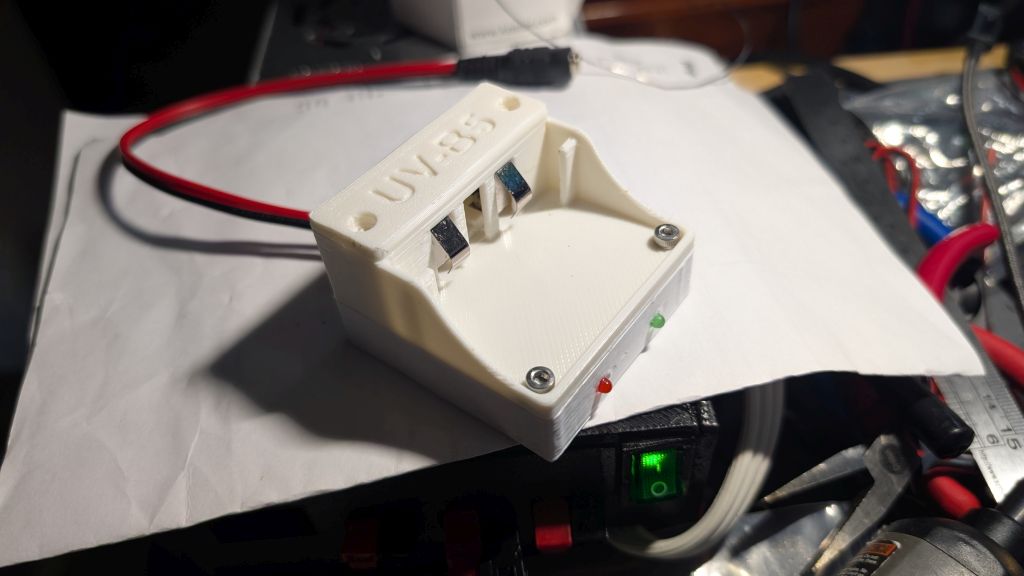

I also did a couple for the UV-B5. The OEM base had cracked mounting splines that kept the radio/battery from being securely held. I used a pigtail barrel connector on these.

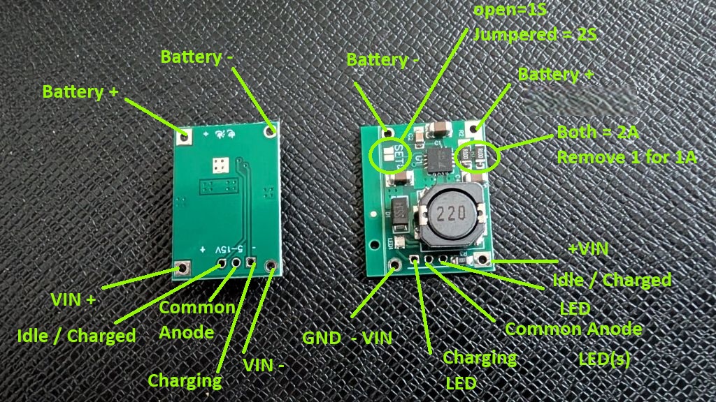

Both styles use a TP5100 charging module. It can be easily configured for either 1S or 2S charging and a 1A or 2A charging current. 1S needs >= 5v, 2S needs 10-15v. I set both versions for 1A charging.
