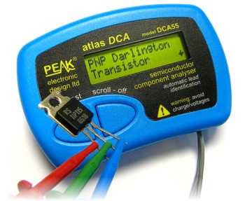

I like. I think I'll order one + case today! I have the Atlas Transistor checker that I paid around $80. They also have an ESR tester that will cost me around $180(CAN) that I have been pondering awhile but not at that price. Banggood it is!

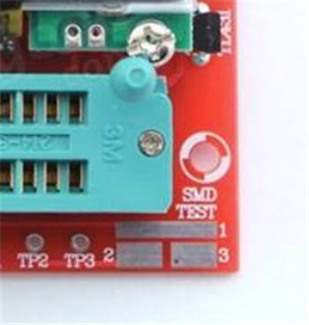

You may have made the right choice. Upon further inspection of what I just bought, I noticed the SMD testing pads on the bottom right of the board. When you use the case you lose access to those pads.
I seldom use those pads. They do work nice. But you can over come that very easy once the case in installed. Etch a small board in the shape of the smd pads. Drill some small holes and install pins so you drop the board into the zif socket and lock it down.
I did this but installed 3 color coded leads with clips. So when I need to test something that does not fit into the socket or something that is in circuit I just plug my little board into it and there ya go.
