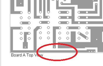

I have my fan connected to a 1/8 mono jack, which is supplied ~12V from the power switch on my DX500. Works the trick and turns on / off with the main power. Perfect...almost.
Hindsight is an incredible thing, and I now know not to unplug the fan while its on...because if you do you create a direct short, and even though momentary, it's enough current to pop a trace like dandy little fuse.
The smallest portion of the + supply to the power switch isn't exactly in a convenient location, either. Directly under the switches on the front board. Ughhh.
I'll probably end up cleaning out the sliver of a trace with an exacto knife (I *think* I can get in there) and jumper a new supply over to the switch, even though it feels kind of half-assed.
Maybe just put a jumper wire across any convenient place along the trace? It doesn't have to be right at the bad spot.
Yep. Unfortunately, addressing the trace directly would require a full disassembly; including removal of the boards and removal of all the switches...suffice to say, I ain't doin' all that.
So long as I can remove the burnt and lifted trace (to prevent additional problems) I'll just jumper from the main positive trace on that board over to the switch.
Yep, I have repaired a few of those traces also.
All patched up and running. I was able to cut the trace at the connection to the preamp switch and remove the sliver without disassembly.
Then I ran a new wire from the pos supply on the front board, behind the panel, and lap soldered to the trace supplying power to the main switch.
Not perfect, but it’s working.
