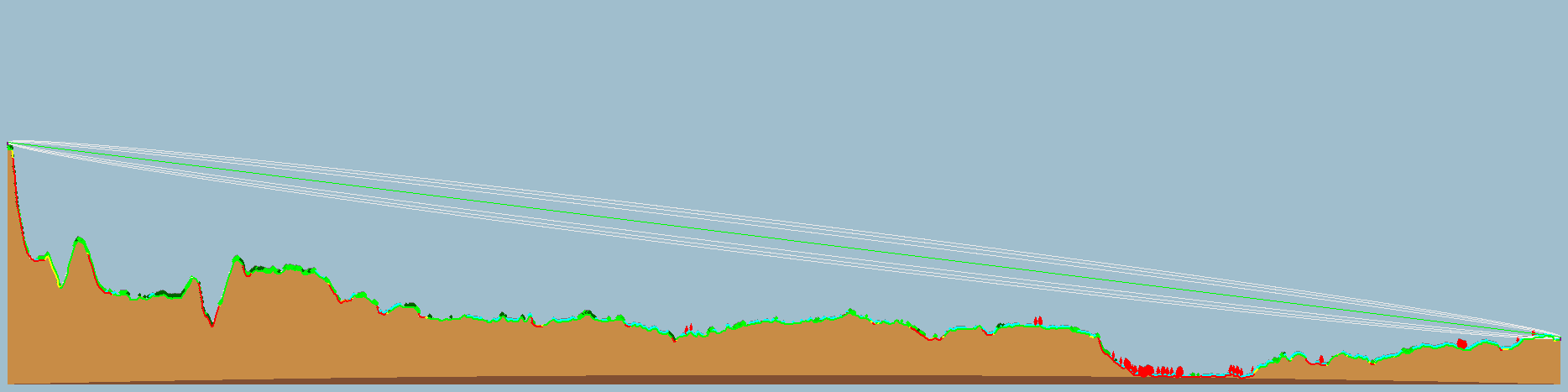

    [​IMG]
    Mt.Enumclaw (1)
    Latitude 47.263824 °
    Longitude -121.899893 °
    Ground elevation 711.3 m
    Antenna height 10.0 m
    Azimuth 310.12 TN | 294.80 MG °
    Tilt -0.96 °
    (2) Kevin
    Latitude 47.511775 °
    Longitude -122.336917 °
    Ground elevation 133.9 m
    Azimuth 129.80 TN | 114.34 MG °
    Tilt 0.58 °
    Radio system
    TX power 26.99 dBm
    TX line loss 3.00 dB
    TX antenna gain 28.50 dBi
    RX antenna gain 8.00 dBi
    RX line loss 0.50 dB
    RX sensitivity -113.02 dBm
    Propagation
    Free space loss 135.43 dB
    Obstuction loss 7.14 dB
    Forest loss 0.00 dB
    Urban loss 2.05 dB
    Statistical loss 6.37 dB
    Total path loss 150.99 dB
    Performance
    Distance 42.925 km
    Precision 21.5 m
    Frequency 3300.000 MHz
    Equivalent Isotropically Radiated Power 177.407 W
    System gain 173.01 dB
    Required reliability 70.000 %
    Received Signal -91.00 dBm
    Received Signal 6.31 μV
    Fade Margin 22.02 dB
    [​IMG]
    Game on :) RM33E73C1B3C4_0.gif
