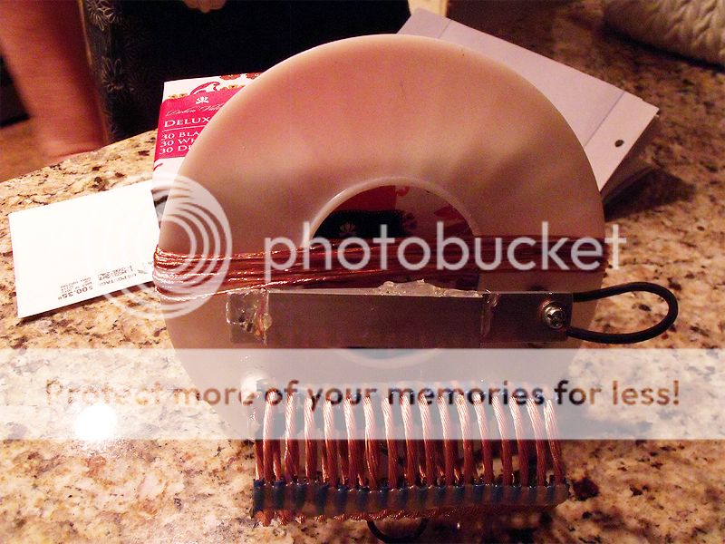

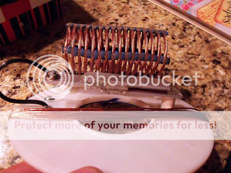

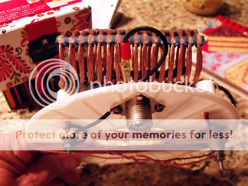

I am going to be away from the house at my in-laws in about 3 week for a week and will need a portable antenna. I have a dipole for that purpose, but decided to throw together a portable end fed wire, too.
The wire element is wrapped around the plastic plate for travel/storage.

If interested, how to make the coil in the above photo.
Materials:
wire
wax paper
blue swimming pool flex hose
Hot glue.
1. Cut a section of this hose, cut it into strips.
2. Wax paper rolled and taped onto cylinder such as PVC pipe.
3. Hot glue strips of hose onto wax paper.
4. Wrap wire for coil around the form into the grooves.
5. Hot glue across all the blue hose strips.
6. Slide wax paper off of the PVC form, remove wax paper from within the coil.

That is very neat Homer. Is this the design that you used to tune your 1/2 wave? Does it look bigger that it really is?
No. The wire portable uses this. The one used throughout the thread was different than this one. However, the half wave does currently use a cap and coil just like this one. I haven't reported anything with it. I can use a housing box much smaller with this design.
