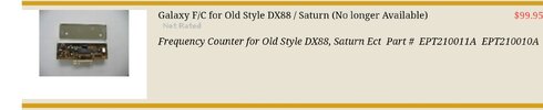

Screenshot_20260104_190214_Samsung Internet.jpgScreenshot_20260104_190150_Samsung Internet.jpg
Reactions: Hawkeye351
That looks like the one that goes in a Saturn that has the horizontal frequency counter module mounted on the right side of the chassis. That one has only two connections.
The one I need mounts vertically behind the frequency display. Mine has 4 connections, two small on one side and two large on the other side.
Mine is laid out just like the 210014C, the one that comes in the 11B. But even the 11B counter won't display in my Saturn. All I did was unplug my counter module and put it in another, I didn't yank any wires out of the connectors.
On the 210014C modules I do have, I've recapped them, and replaced the 7805 regulator, still no display at all. The 210014 doesn't have any diodes on them (the typical 2.4v diode that leaks and causes this issue).
