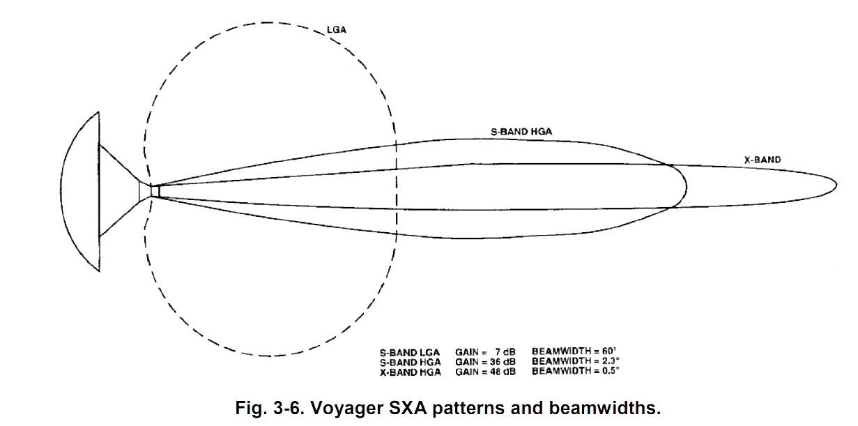

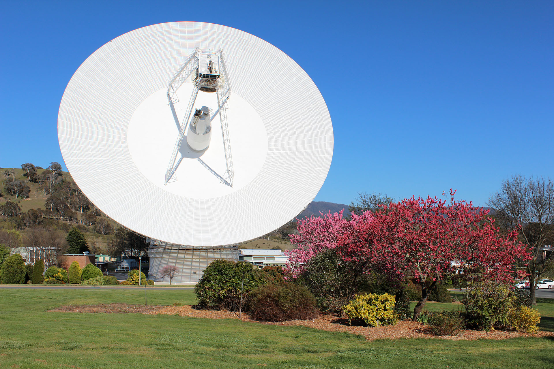

The real problem is building an antenna large enough to overcome the path loss at that distance (enormous). Antennas with those gain numbers are not wideband either, so no voice. Gonna need a monster CW station on an atmospheric window frequency to get that alien QSL card.
