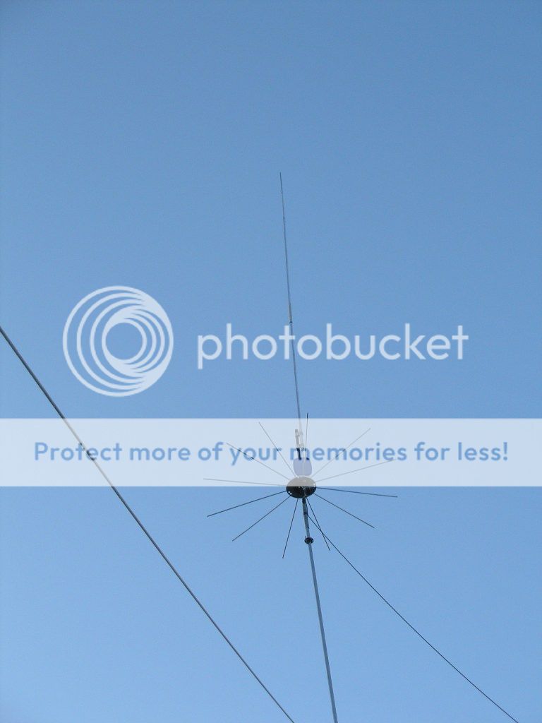

I wanted to give you a photo of the radials/antenna combo I was using when I finally rested from working on it.
This is the matching system in a smaller box as I am currently using it.
There were 12 x 48" radials. The vertical aluminum radiator descended right down to the top of the radials behind the box the matching system is in. The clamps holding the antenna to the mount/mast were attaching the metal antenna to a nonconducting fiberglass tube for 2' below the radials.
