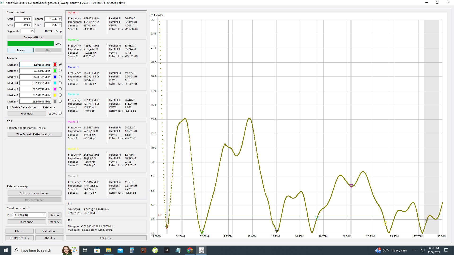

final off center fed dipole results.
nfsus
Yeah its turned off, touch it
May 9, 2011
592
316
49
Arkansas
131.5' antenna cut at 70/30.
4:1 ruthroth balun at feed point
100uf 3k volt disk cap fed through between balun and long leg
1:1 Guanella coax choke below balun
106' rg8x coax
40' kinda sag flat top.
