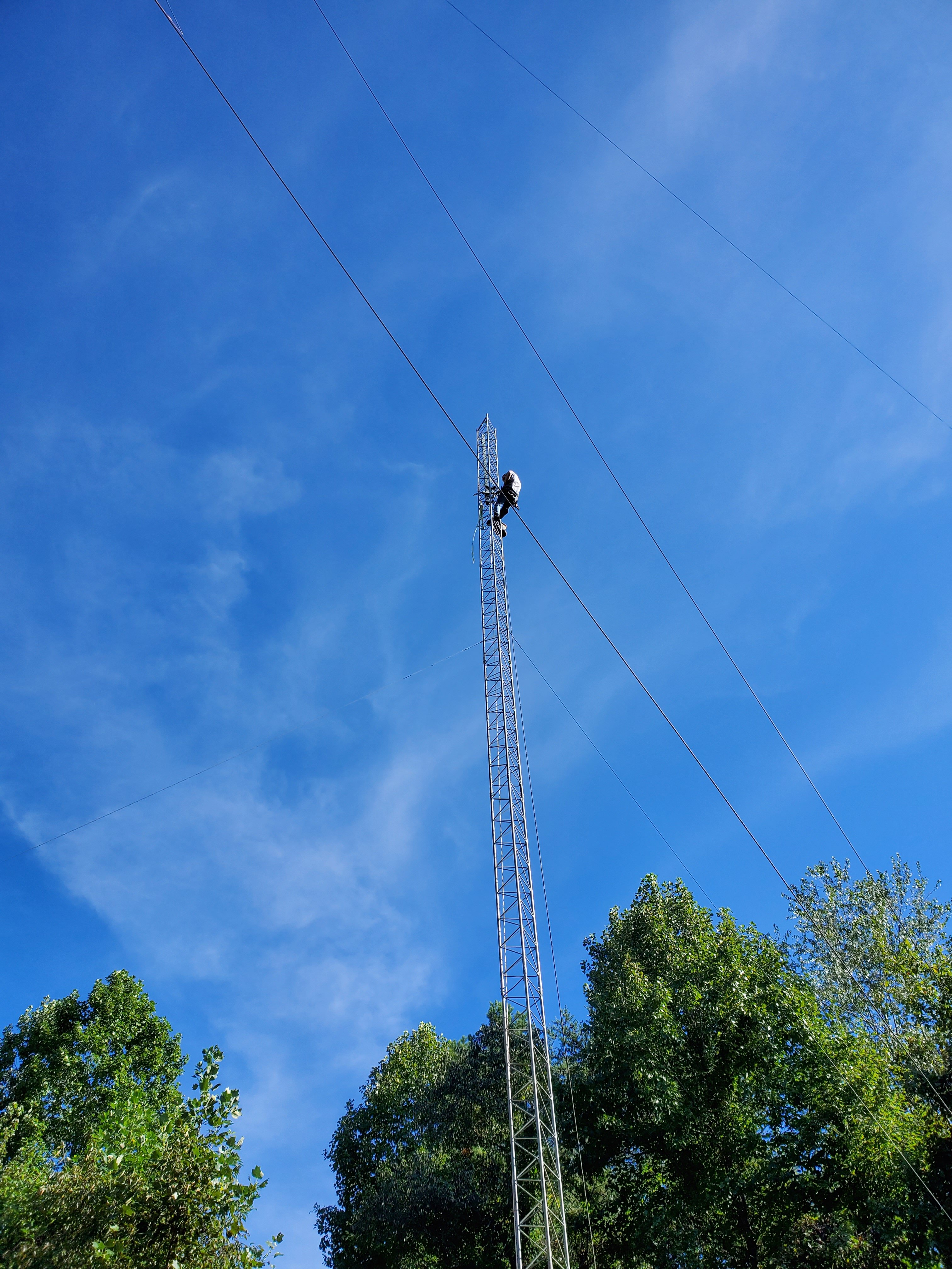

Well finally got all the tower stacked. Got 76 feet of Rohn 45 up. The beam showed up today so next to get it put together. Here's a couple pics. Don't laugh at the home made gin pole lol. It and a heavy duty ratchet strap and a 1/2" drift pin did the job. 2 pulleys one on the pole and one at the bottom and a 4 wheeler to lift the last 5 sections and its up lol. More to come stay tuned lol.
