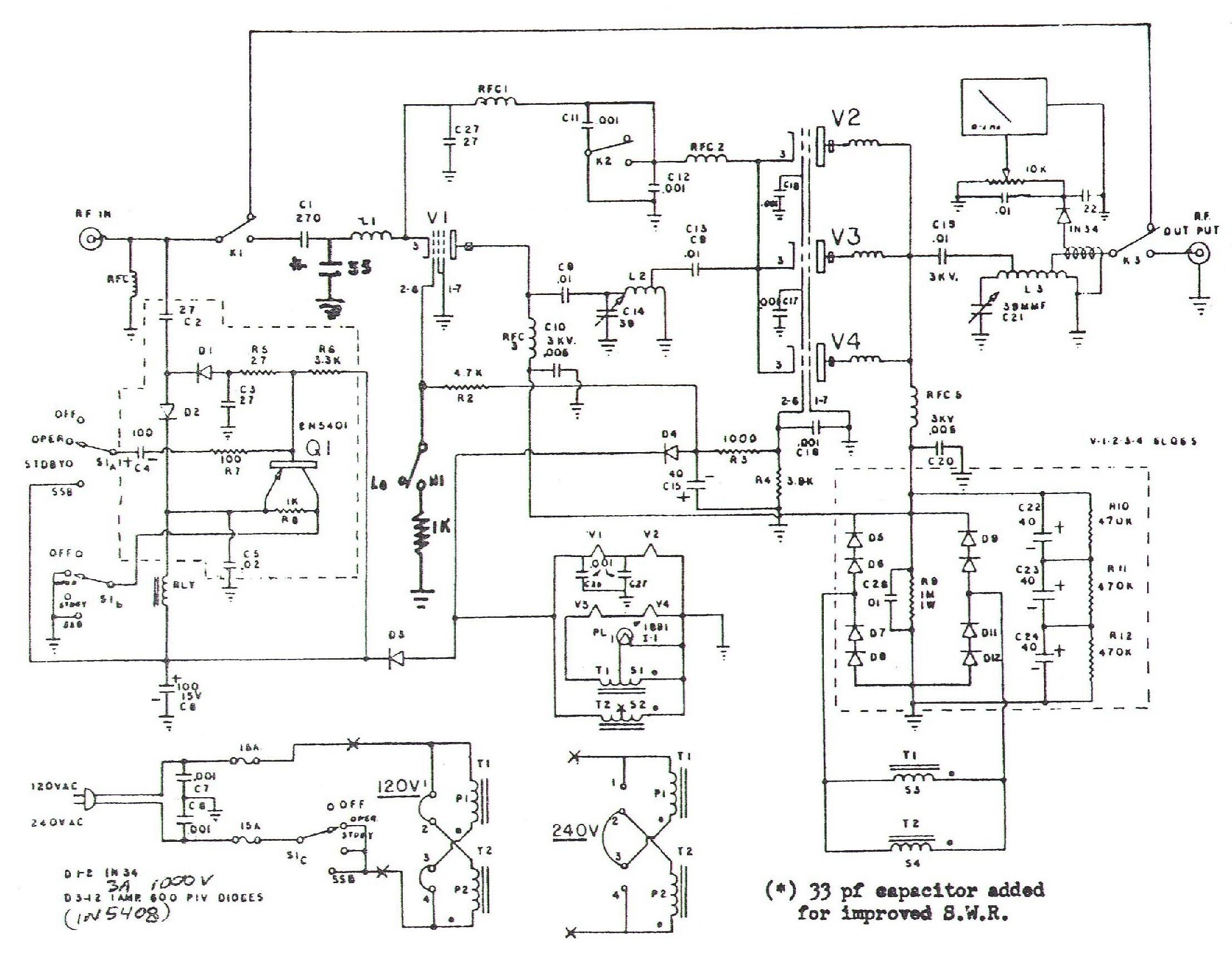

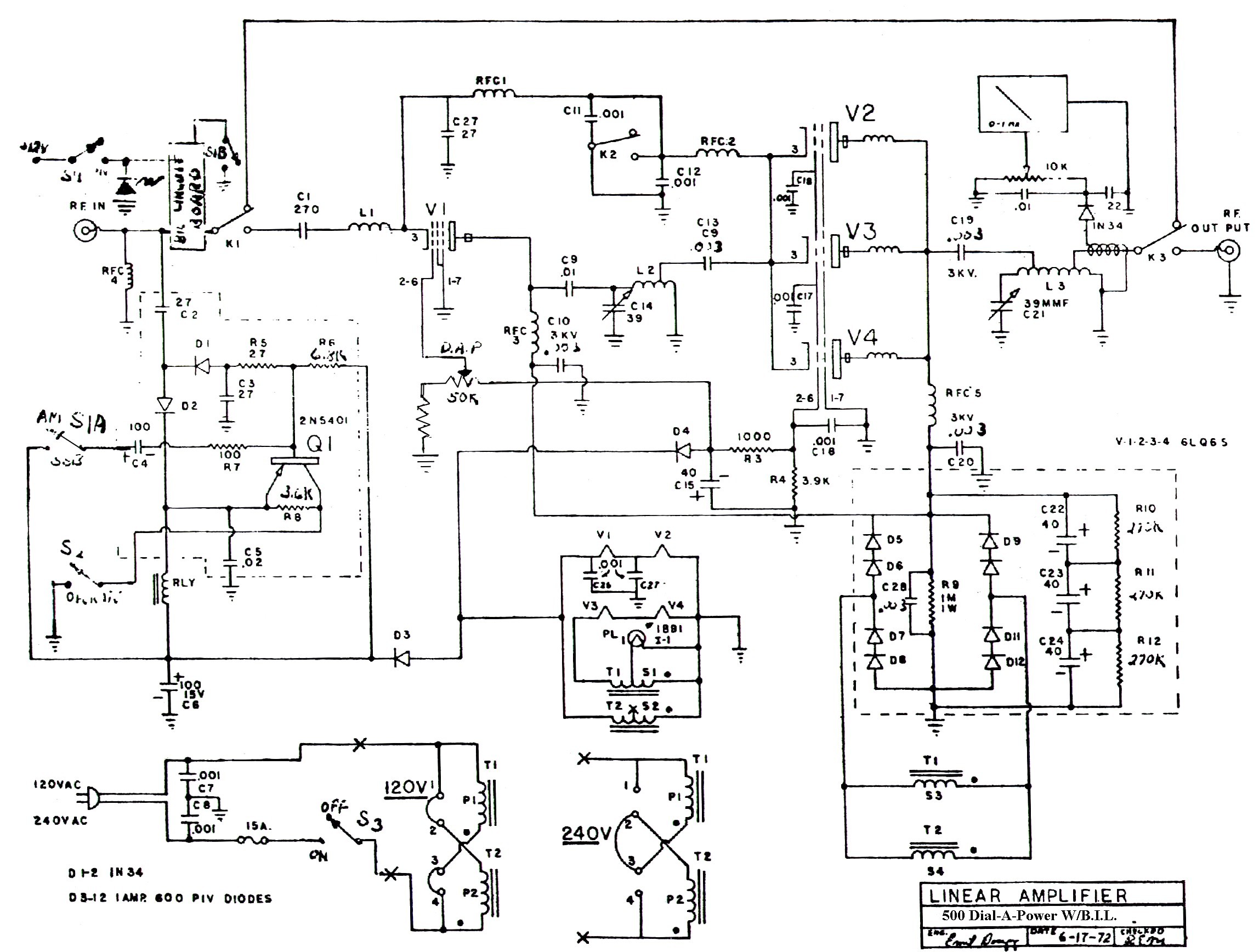

Would anyone happen to have a wiring diagram for this unit?
See above.
Jeff
