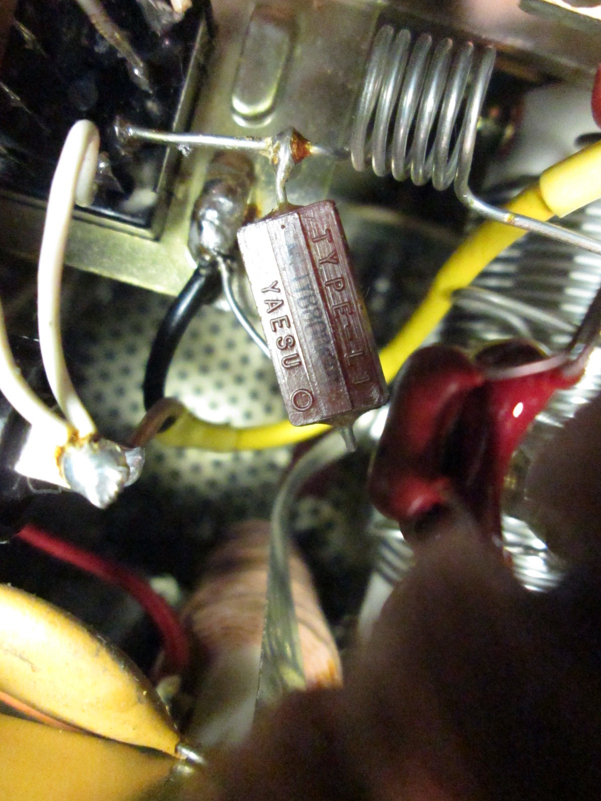

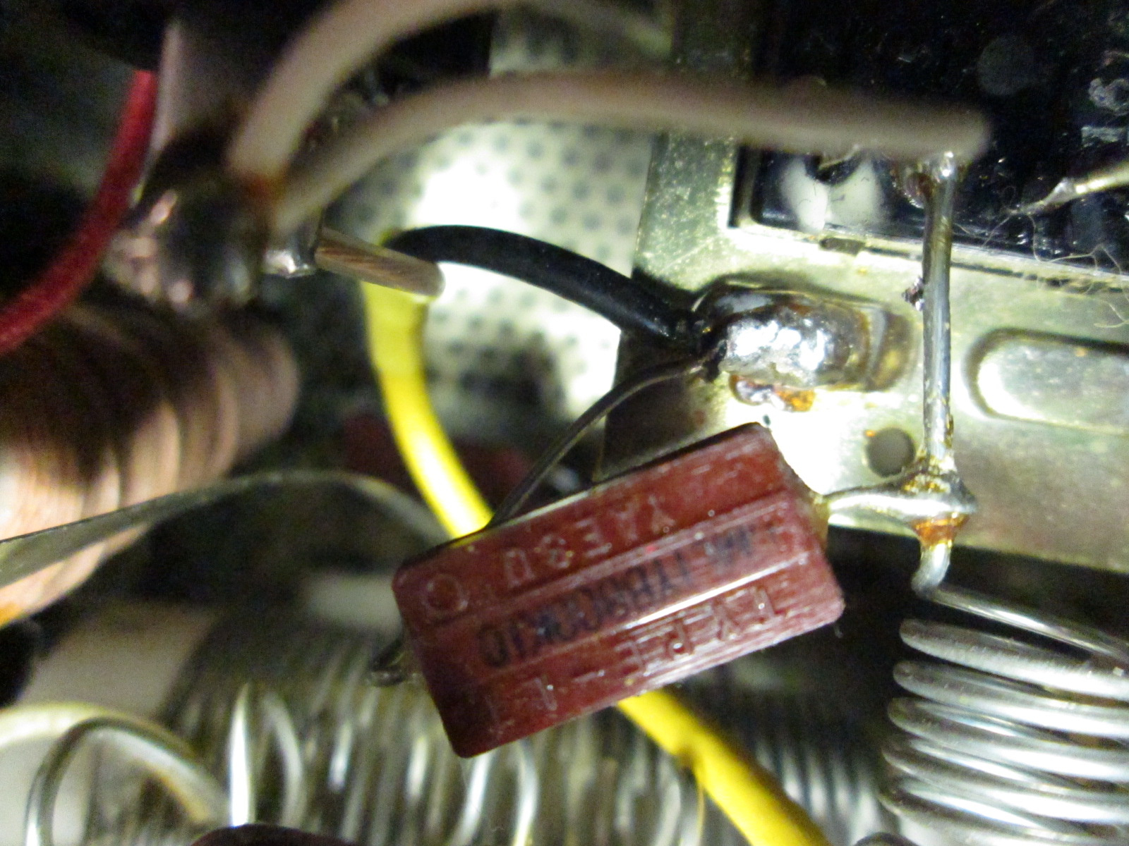

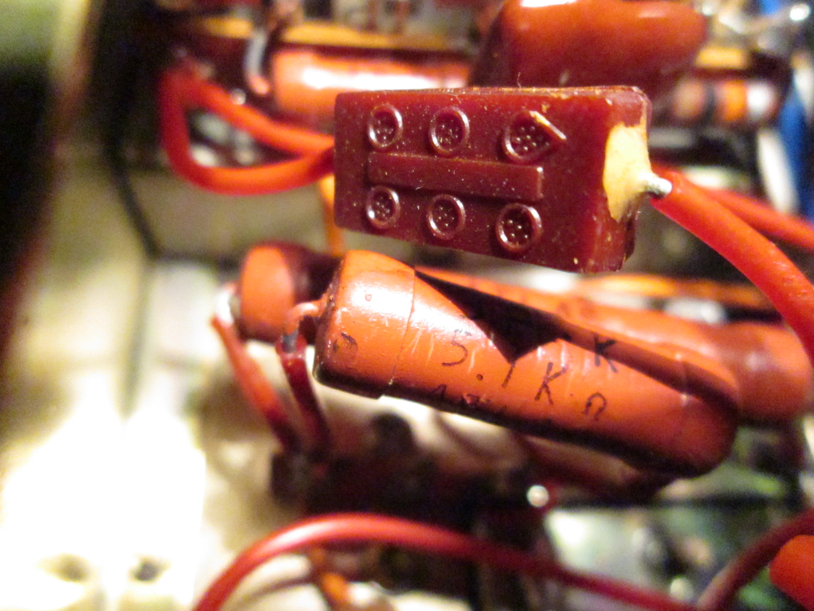

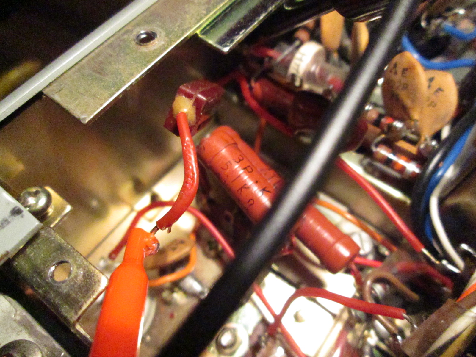

I tested both these and they came up as 112PF 17 ohms
The word on the street is to change C13 before it goes bad, looks like people should do C104 too.
Anyone know what tolerance these are?

I pulled and replaced C13 and it tested 92pf when it was free and clear.
Goes to show testing with just 1 leg undone doesn't give a accurate reading.
It showed 112pf half in circuit
