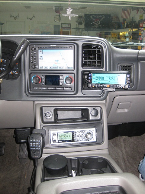

    I just finished installing the FTM-350. So far it's still working great.

    Looks good! What mount are you using with the control head?

    I'm using the proclip system. This way I'm not drilling into my dash. I added a different connector to my radio which allows me to remove it quickly and take it indoors at night. The clip works great becauses there is room for the GPS unit.

    so the mic mounts to the box, not the control head.... i like it. very cool radio. wish i could afford it. ;)

    It will mount to either place, which is nice.

    i believe it has a plug spot on the head and on the main box for the mic ...

    Yes it does, which is another nice feature. Most will want the mic plugged into the control face when the two are separate. I, however, plan to put the display up on the roof of my Jeep (which is converted to a pickup truck with a custom hard top) and will have the main box just behind me between the seats. So I'll likely plug my mic in there instead of the control face because it'll actually be closer to me that way and won't result in a dangling cable.
    Ah, flexibility! Now if Yaesu would ever get the stupid GPS cable available. Because of that location I can't really use the internal GPS and need to do it external. Apparently the sell EVERYTHING you need for that little endeavor except the cable. :(
    Cable supposed to be available soon. We'll see.
