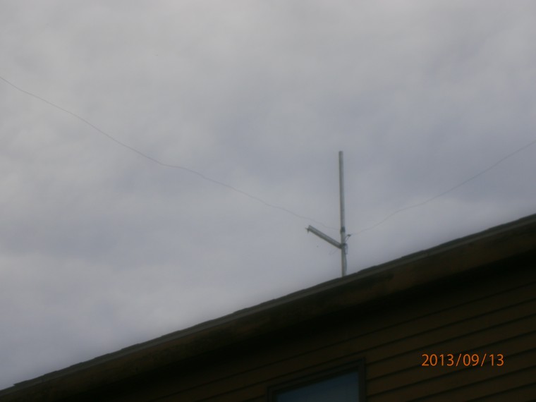

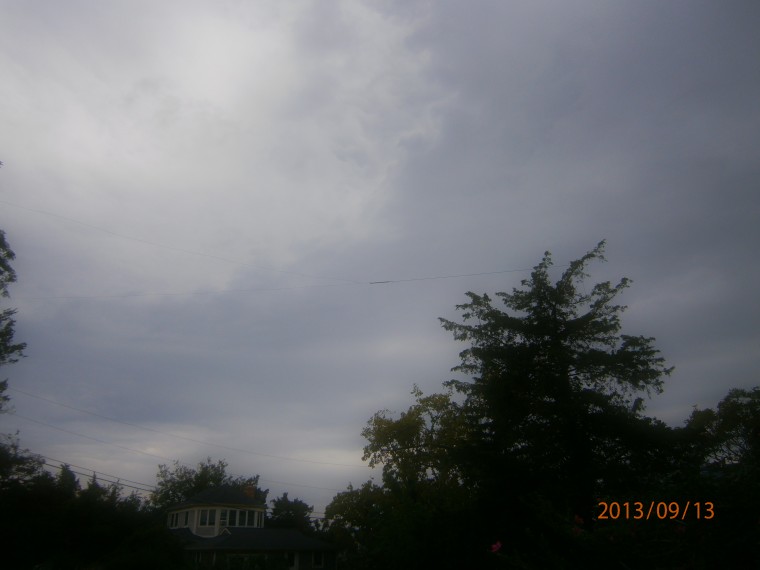

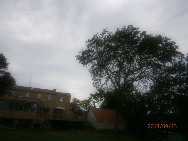

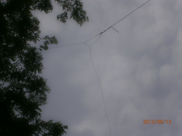

I got a wire up. The length is about 275 ft. I can trim it if I need to I have not hooked any coax up to it yet.

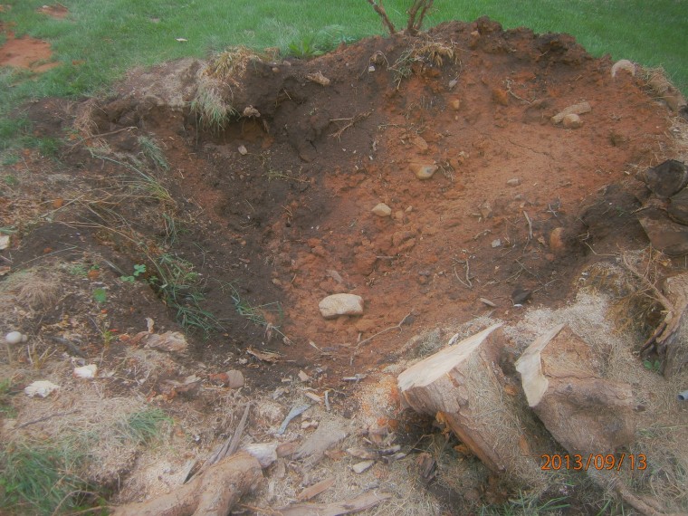

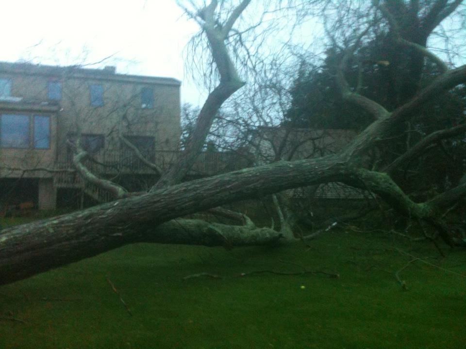

Here is the tree that fell down during tropical storm sandy. It was a locus which is a really hard wood. Boy what a pain to cut up took a couple days and 5 or so chains.
If you look closely you can see the white piece of teflon that I used for the center feed point and one of the wires for one side of the dipole.
Thank god I disconnected the tension weight on the house side. I forgot to disconnect the tension weight on the other side which went to a sail boat mast which was mounted in a tree at the back of the property. The wire consisted of #12 copper weld wire. Well to make a long story short when the tree fell the sail boat mast snapped in half and the mast guy rope kept the mast close to the tree. The copper weld wire and the parachute type rope were unharmed.Boy that wire is strong.
