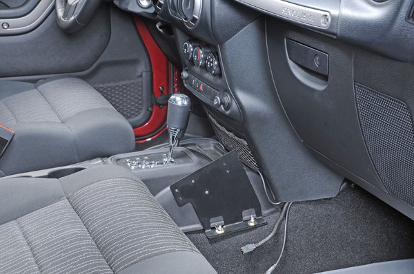

Actually I mounted it on the side of my center console. I will try to load a pic later but it is mounted at a slight angle. I didn't want to fish the coax up the dash plus the overall size of that radio made it almost impossible to mount on the dash.
Yes the size of the radio is what had me confused. I wanted to put a Magnum S9 on top of the dash but it was just too big with the heat sink in the back. I opted for the Magnum 257HP and hate it! Yes, hate is a strong word!!!
They make a mount plate for the side of the console but I just used four screws and set it at an angle and she has been fine.
Here's what the mount looks like.
It will limit how far up the passenger seat can move up. Not a problem for me but just something to keep in mind.
