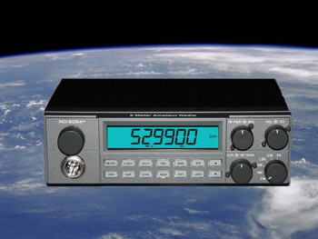

Would you call this RCI 6 meter radio a amateur radio?
No. They've just tweaked their 11m set for 6m and still got a roger beep I see. Its also got no CTCSS so no using 6m repeaters and no pre-amp which is a must. Selectivity is a joke at -55dB which wouldn't even make Sherwood Engineering's receiver test data table and that has radios on from the 1960s.

It takes a little more than tweaking to make a 11 meter radio receive and transmit on 6 meters. The RCI 5054 radio was designed to be a 6 meter transceiver from the start even though it uses the same chassis as the 2900 series, it will not open up and transmit anywhere near 11 meters.
Like the 2900 series, the radio is CTCSS capable with split frequency but you have to purchase and install the CTCSS board yourself. Ranger will do this for $40.00 but you have to purchase the board yourself and send them the radio.

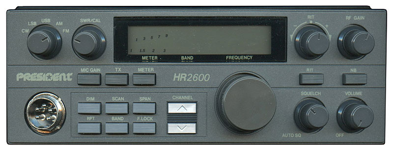

How about this radio, not an amateur radio either?
This one comes with a factory installed CTCSS board which comes on when the repeater button is selected and in FM mode. It also goes into -100 KHz split mode automatically too. All this is done simply by pushing the RPT button.
Notice it has VFO tuning and RIT controls and a handy TX button, and look! no tinker bell! (roger beep). Unfortunately no preamp, but I hardly use them on my IC-7000 and TS-590.
I have 2 of these and they work ok for 10 meters.

The 5054 was developed by Ranger at my request. In talking with a Kenwood dealer back in 1999, he indicated that if Ranger could make a single band 6 meter radio for use by new licensees at price X, then he believed about 150 units could be sold per month. In order to get that price point, certain sacrifices had to be made. The dealer was exactly right as to the number of units to be sold at that price point. The radio was always intended to be marketed strictly as an Amateur radio, aiming at the new licensee market
