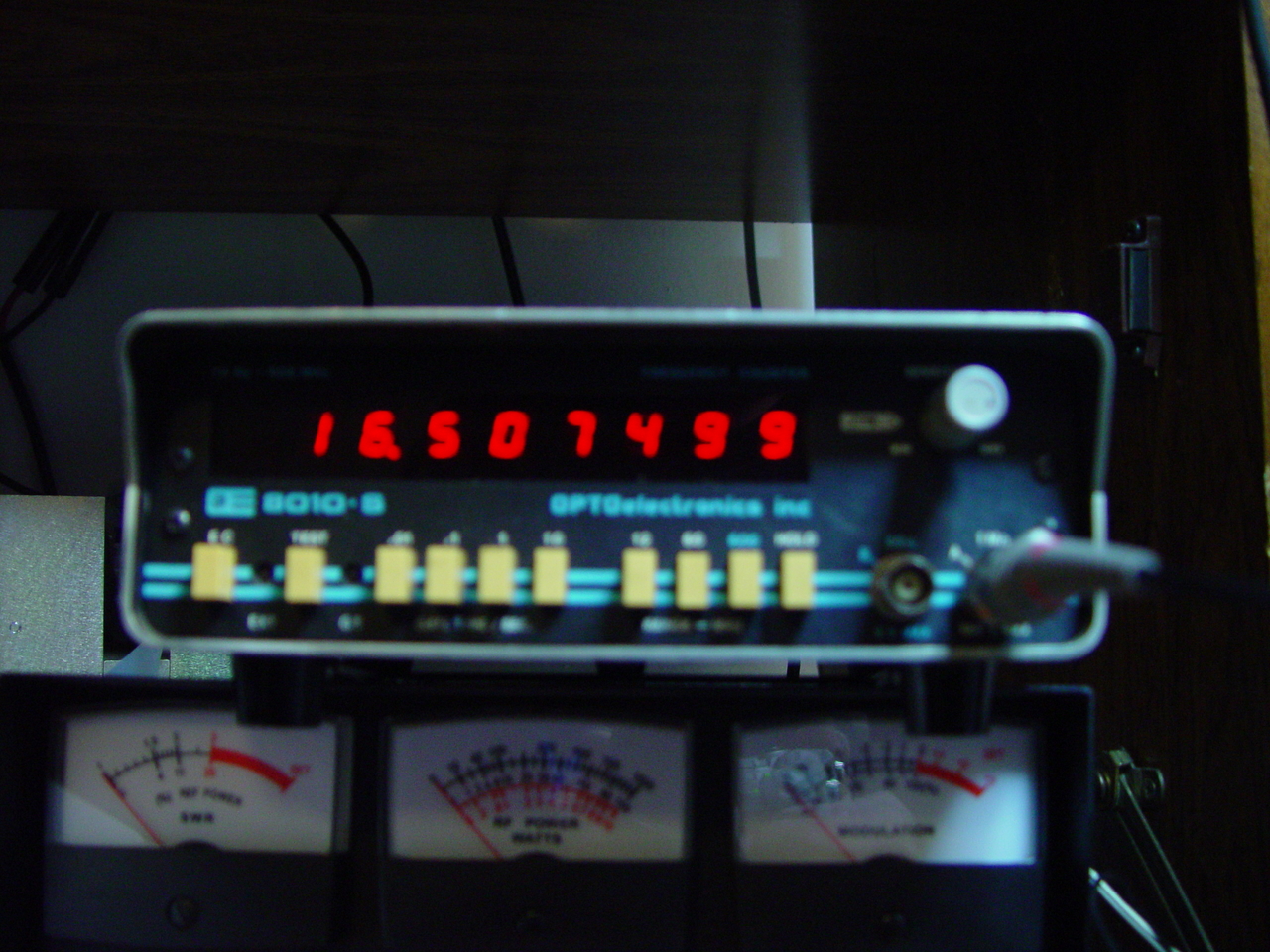

This is one alignment reading on a 959 Galaxy. On this part of the alignment it is only ONE Hz from perfect. I watched it quite a while and it did not drift while I watched. Radio was on for 45 minutes before the alignment was started.
