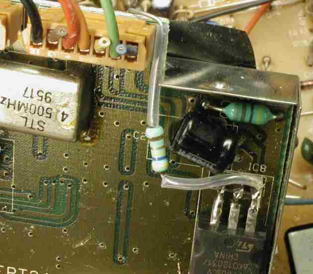

If the failed counter module is the small one make sure the 7805T has input voltage on it. There is a surface-mount resistor in line with the regulator's input that fails regularly. Somewhere I have a pic showing how to jump around it with a 1/4-Watt 47 ohm resistor.
Reactions: Hawkeye351
If it's the same one that's in the RCI radios he's not kidding about that. The only RCI I have (2980) came with a dead frequency counter. Opened it up to find that the surface mount resistor was gone. Not burned out, missing entirely. Bodged a 1/4 watt resistor in it's place and no problems since.
Not the best quality pic, but we had tiny teflon sleeve on hand, and this is the least-labor fix for us.
