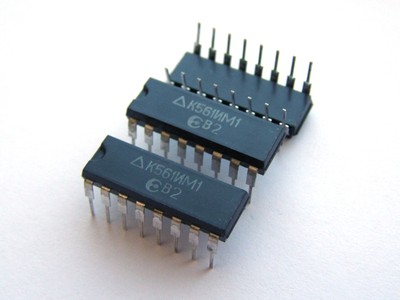

I'm curious if the ex- USSR equivalent adder chips are worth their weight in sand. I found this listing on eBay from Ukraine, but couldn't find any info or datasheet on that adder ic (id be surprised if I did, honestly). At 50 cents apiece, sans shipping, it's in my budget. I'm wondering if they could work for a 4008 replacement and if anyone has any experience subbing old Soviet ic's. I see someone has recently purchased these, so someone else may have the same idea.
I've heard that while the USSR was a scientific advancement collective, they put price over quality, and thus their ic's were failure prone. Any remarks?

I wouldn't without a data sheet to at least see if the pinouts are the same. Equivalent may not mean drop in replacement.

Those parts might very well work, if they were meant for military use.
A 30-buck chip tester from fleabay would reveal parts that just won't work at all.
Thanks for the feedback guys, and the story, I bought some to play with anyhow, and I was able to find cross references from 2 locations, both in Russian?, which seem to say they were clones of the cd4008. I will update when they arrive, if they work as a drop in they could be a good cheap source.
Update: they have arrived!
I looked them over and the markings match the picture. I replaced both adders in a connex 3300 test radio, and they can add binary bits the same as the 4008s that were in it. So far, so good. Interested in seeing how long they can cut the mustard, but my gut says they will last.
Now, I didn't test all of them, but the few I plucked were good.
