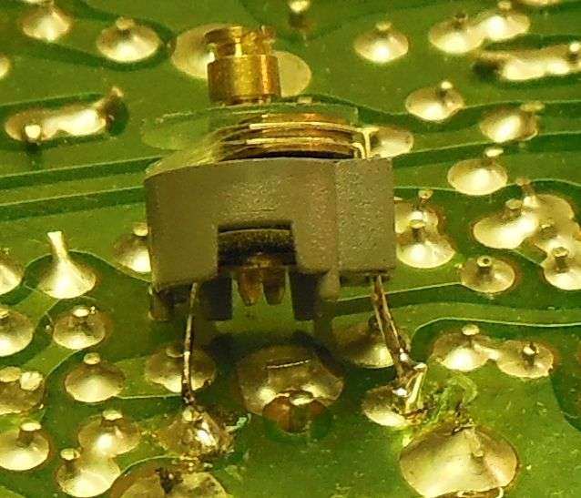

Ok, done some proding around L13 and L14 with a small metal shaft screw driver with my finger touching the shaft of the screwdriver.
The only spot that the receive on sideband improves to normal, is the unused pin (on the 3 pin side) and the outer pin (on the 2 pin side) of L13.
Replaced C89 with a new cap of same type and value, no change in SSB receive. Tried different values (up and down in value), with no improvement.
Did the same to C43, no change in receive on SSB.
The only thing that brought the SSB receive up to normal, sounded normal and S-Meter movement improved on SSB was touching those 2 places on L13. Receive sounded awesome by touching either of those 2 legs on L13 with a metal screwdriver with my finger touching the shaft of the screwdriver.
Should have asked about the position of the tuning slug in L13 and L14. When you touched one end of the primary winding you added capacitance. If that brings up the signal, it tells us that L13 is tuned to some frequency above where it should be.
Makes it sound as if the tuning slug on L13 is dead flush with the rim of the hole.
This happens when the coil's built-in capacitor fails. That "dead flush" position is where the coil's inductance is maxed. Makes it look like a peak, but it's not. It's the coil getting close to resonant, and then farther away as the slug rises above the rim of the hole.
Adding back the missing capacitance is easier than replacing the whole IF transformer. The schematic shows the internal capacitor across the primary winding, but doesn't reveal its capacitance value. We keep a bag of 30pf trimmer caps handy on the bench for this purpose, like the one in the pic. Goes across the two outer pins of the 3-pin side.
Might take more than 30pf for L13, don't have a bench note on that. If you try this, and the trimmer goes to full capacitance without getting a peak, then it needs more capacitance.
I normally back the slug two turns down below the rim before trying to peak the trimmer cap.
Kinda like "Tune and Load", might be some back-and-forth between the tuning slug and the trimmer cap to get a proper resonant peak.

I removed a 25pf NPO cap I had soldered on the outer 2 pins of L13 and now the sidebands don't run into each other as before.
