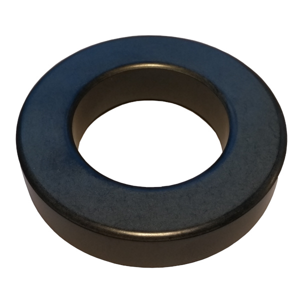

Bonus Question; I've seen a handful of people putting a single ferrite toroid on each of those power leads(2-3 loops through the toroid). Anywhere here do that, and if so, what size toroids are you using?
A good guide for amp draw vs. wire gauge vs. length of conductor.
AFIK toriods on power leads are to reduce electrical interference to the receiver through the power leads. Older CB radios used a filter choke (looks like a small transformer) for this purpose. I suppose that filter chokes got too expensive so the "replacement" became RF chokes from power socket to PC board. Ferrites may well do a better job of "interference" reduction but can be frequency (as in the frequency of the interference that needing to be blocked) specific in the type of material the toriod is made of.
