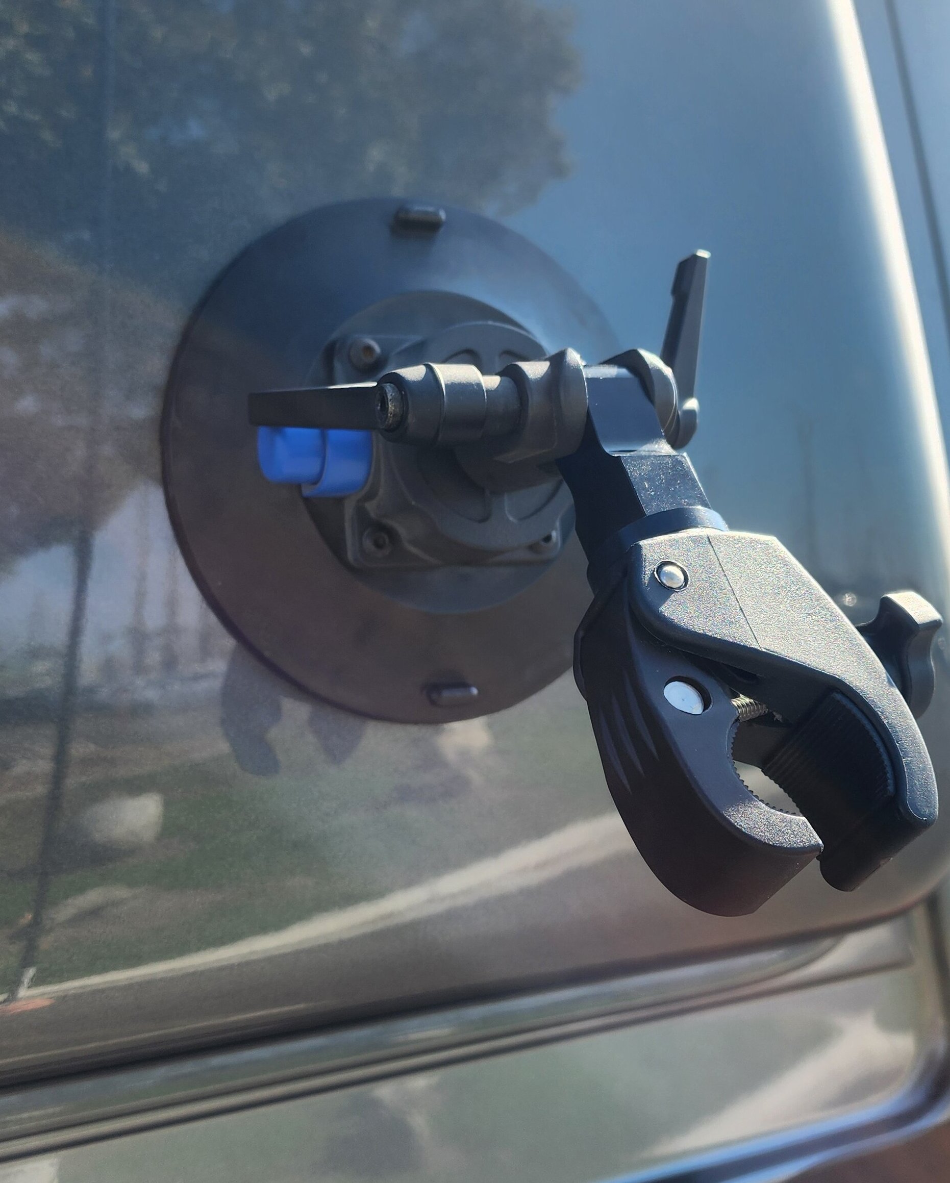

My wife's cousin showed up for the holiday weekend in his overland van. This thing is outfitted to go anywhere, but has no antenna mounts. It made a perfect excuse to drive down by the marina to get some fresh ocean air and try out this suction as an antenna mount. The version my friend has is the large 6" inch suction version. The arm articulates every which way and has two large cams to tighten it once you get it in place. The grip opens up to 1.5" at the narrowest point, which is large enough to fit the Chameleon mini Unun base, or any antenna mast. The claw is some type of tough non-metal ABS, which means you can attach it directly to any part of an antenna.

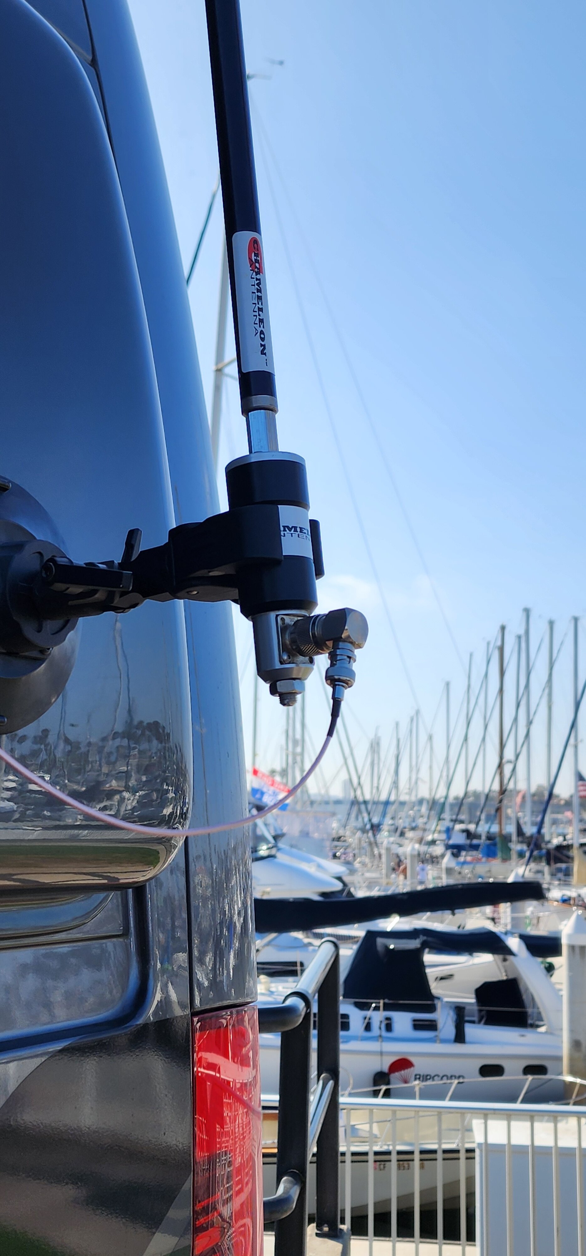

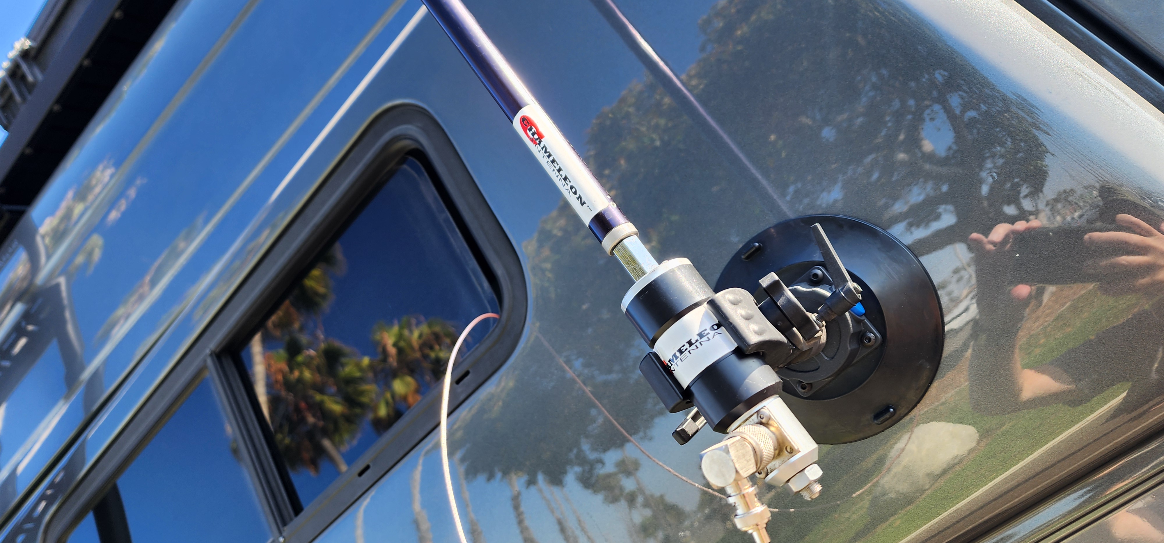

I attached the mount to my Chameleon vertical antenna as seen here:
full
This antenna is about 18 feet tall (or so). The clamp isn't quite strong enough to hold an antenna of this size at an angle - and I'm not sure why you would want to do this - but it holds just fine vertically.
full

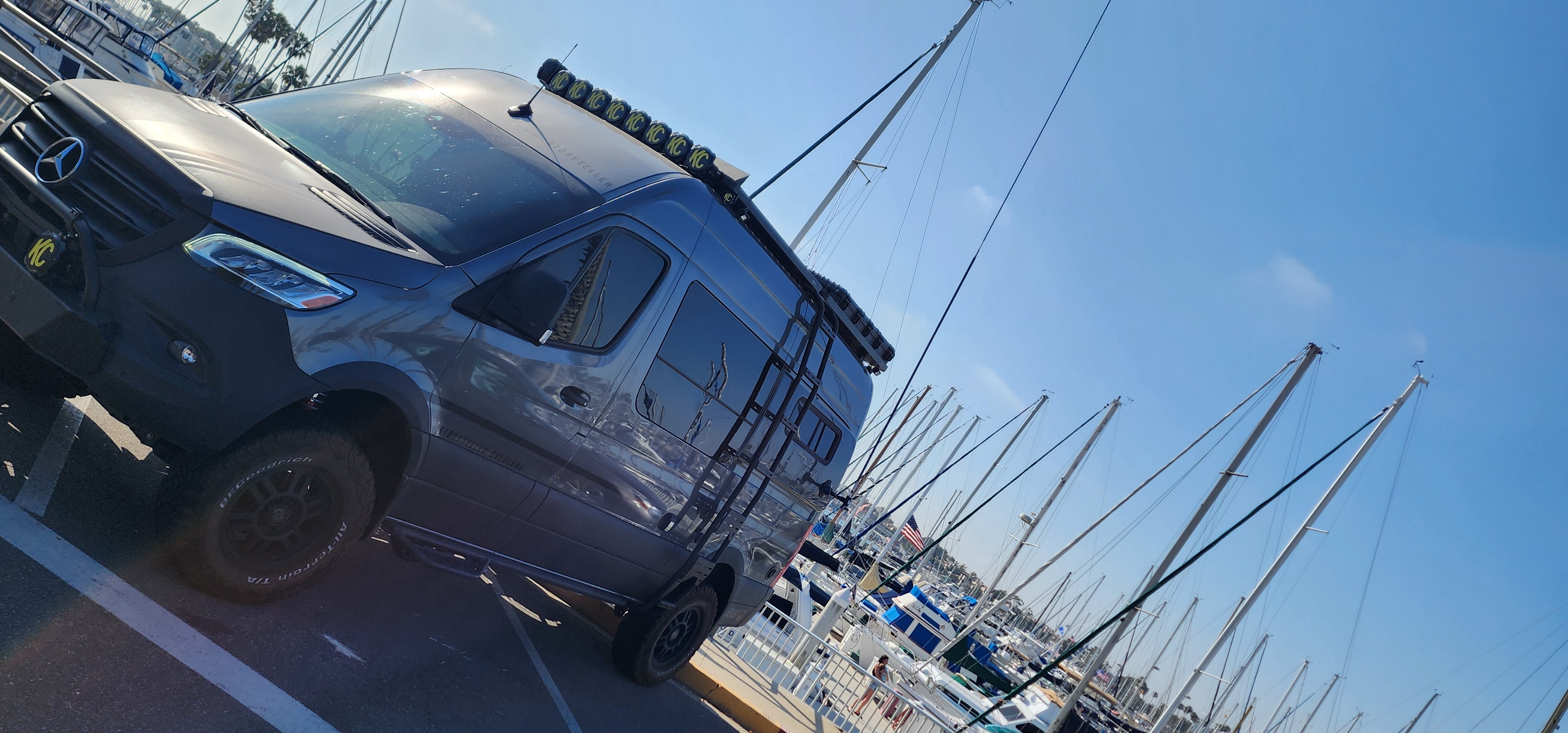

Here's a pic of the antenna on the overlander:
full

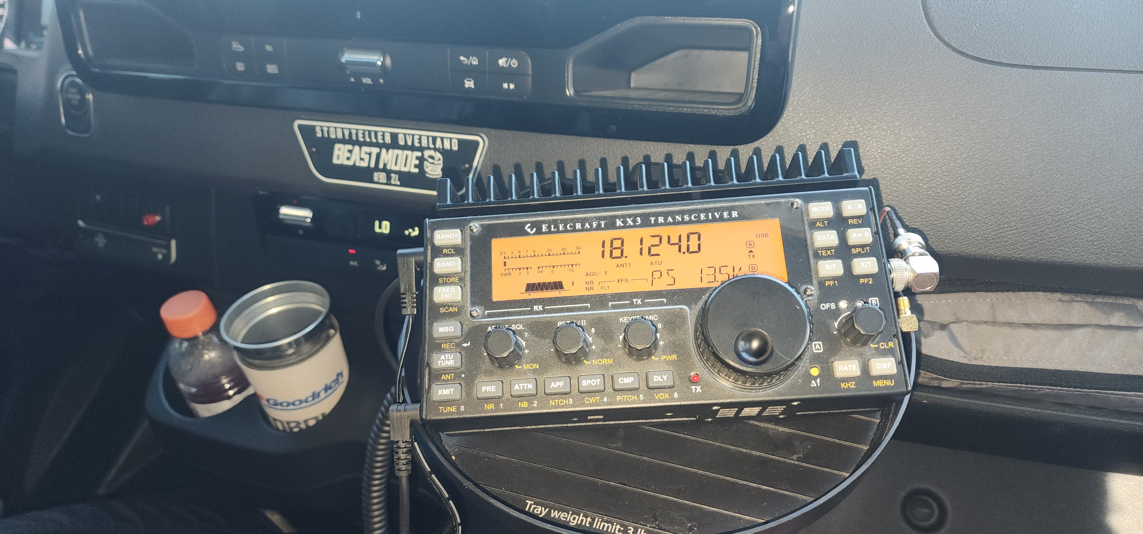

I ran the coax up through the middle of the van to the cab where I placed the Elecraft KX3:
full
This setup worked pretty well. It took me longer to take pics of the whole thing than actually set it up. I had the antenna in the air and radio online in less than 10 minutes.
