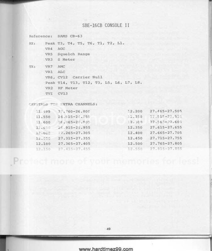

How did you make out with that crystal conversion? I have a SBE console II that has been done up to 27.555. I need a little more, where can I get crystals, here is a list of what I need.. Thanks
